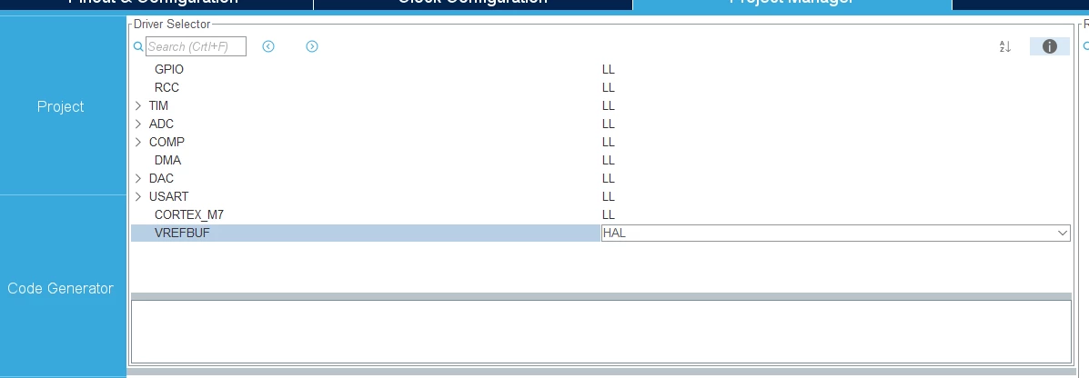

Actually, for VREFBUF peripheral, the LL driver is not supported by STM32CubeMX. Thus it is not available and it can't be selected through Driver Selector Panel.
Nevertheless, the project can build correctly even when using both drivers HAL and LL.

Just after I enable the VREFBUF peripheral, cube display it using LL, but if I click it, it will change to empty, after that I only can select HAL in list box.
For cleaness reason, I am trying to create a pure LL project:)
This is odd, I assume this behavior is not systematic because I couldn't reproduce it from my side. For VREFBUF peripheral, CubeMX is only showing HAL driver: LL driver isn't displayed in any case.
