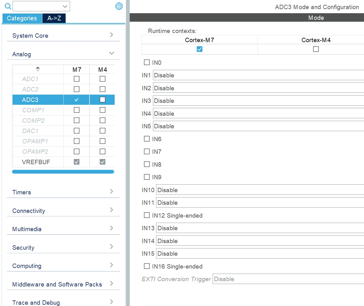

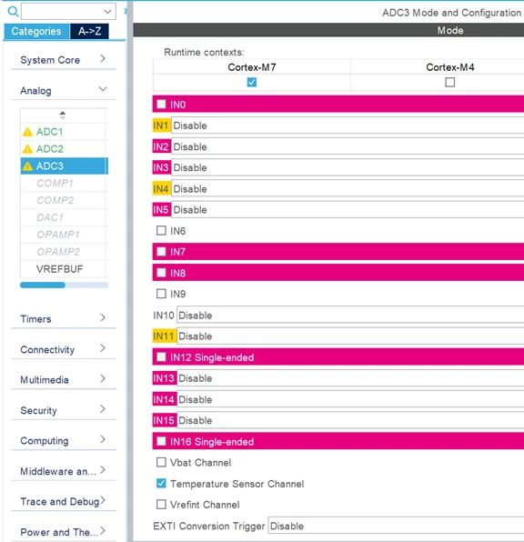

I'm using STM32CubeIDE and targeting STM32H745IIK6.  When I was using the CubeMx plugin version 6.10.0, I was able to enable the temperature sensor input on ADC3:
After upgrading to CubeMx 6.11.0 with FW package H7_v1110.zip, this option (as well as the two inputs listed immediately before and immediately after it) are now gone:
With upgraded SW/FW:
The three options that used to be listed towards the end of the page, between the "IN16" input and the "EXTI Conversion Trigger" are missing. Are they available elsewhere now?

This is a known regression in CubeMx.
See this thread.
