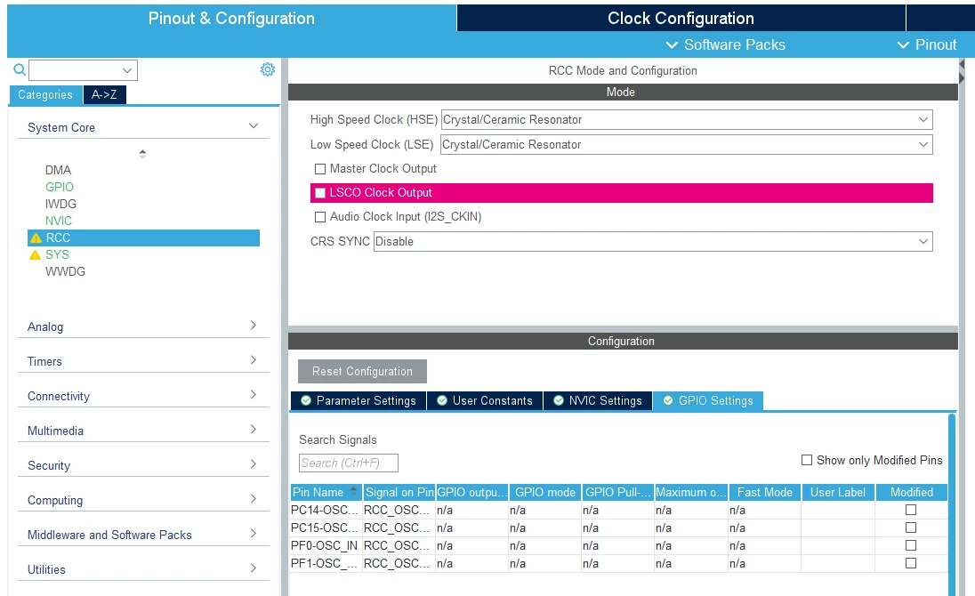

hello,
I have a very simple question, I have asked a FAE,but not solved.
I am using STM32CubeMX to config a project. I used an external 32.768khz crystal. I want to set the RTC clock to the external crystal.
below is my setting.
I think i have enabled HSE and LSE.
the clock to RTC is fixed to LSI RC, but I want to use LSE, not LSI, how can I setting?
Thanks,
dqsh06
Best answer by dqsh06
I have attached the solve method on the reply.
as below
if you check the activate clock source, then you can choose to LSE.
Best Regards,

Could you please share your ioc file?

Andrew Neil
July 22, 2024
@dqsh06 wrote:
I have solved it.
For the benefit of future readers with the same problem who may find this, how did you solve it?

KnarfB
July 22, 2024
Did you enable RTC before setting RTC Mux?
