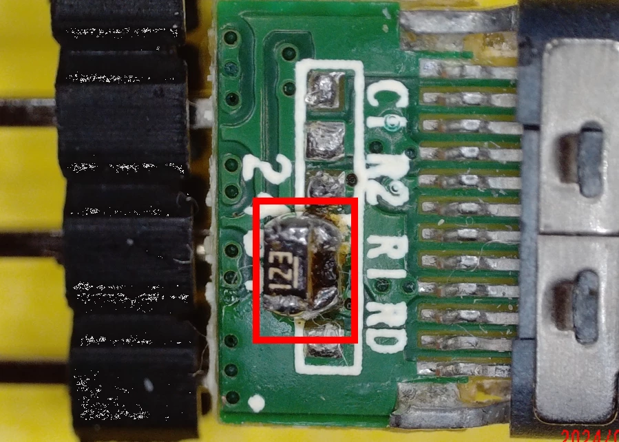

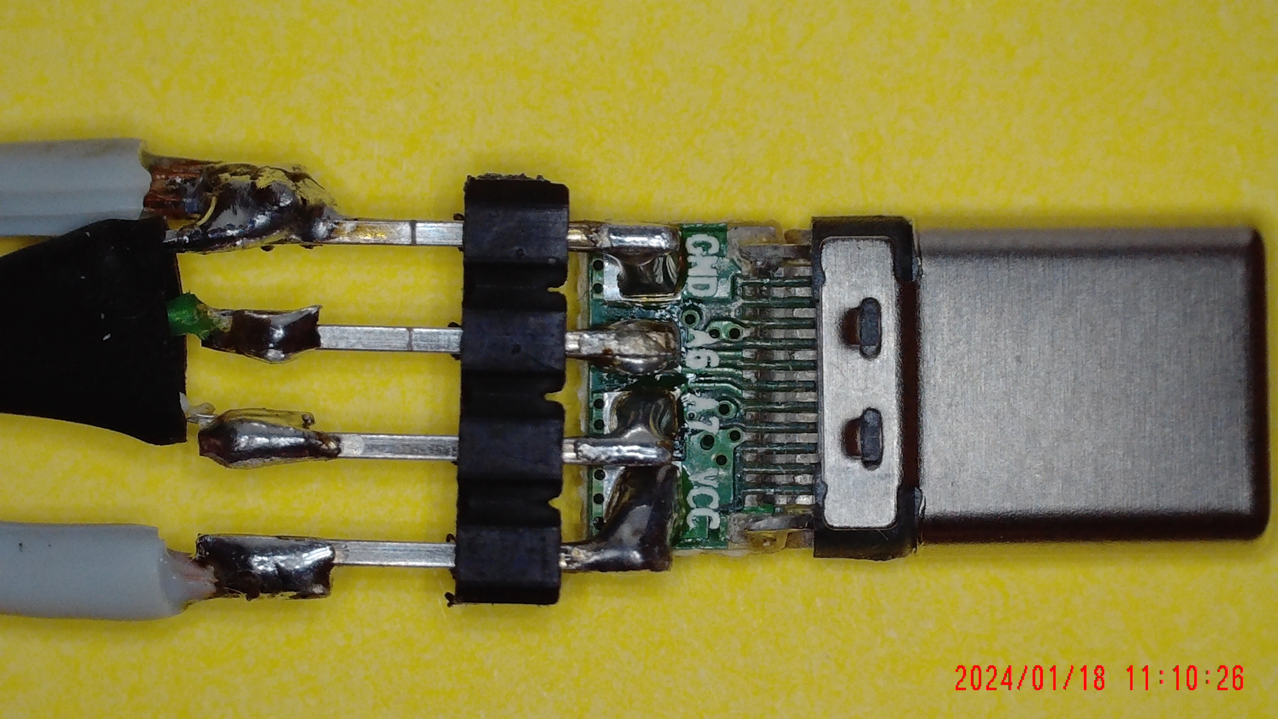

Jan 18, 2024 10:02 AM UTC
Hi @Mikroproc ,
i used a USB-HUB (2.0 or 3.0) and a standard USB2.0 Cable
Cut the USB2.0 Cable on the other side
Connected the open end to a USB-C Adapter-Board (https://www.ebay.de/itm/183278368973)
The Power Supply is external (i left the VCC Connection from USB-A to USB-C open)
USB-A_VCC --- (no connection)
USB-A_GND --- USB-C_GND
USB-A_D+ (green) --- USB-C_A6
USB-A_D- (white) --- USB-C_A7
Ext. Power Supply_+5V --- USB-C_VCC
Ext. Power Supply_GND --- USB-C_GND
The USB-C adapter board comes with a 56k resistor installed (CC to VCC)
I soldered a 12k resistor parallel
Good luck, Fred
