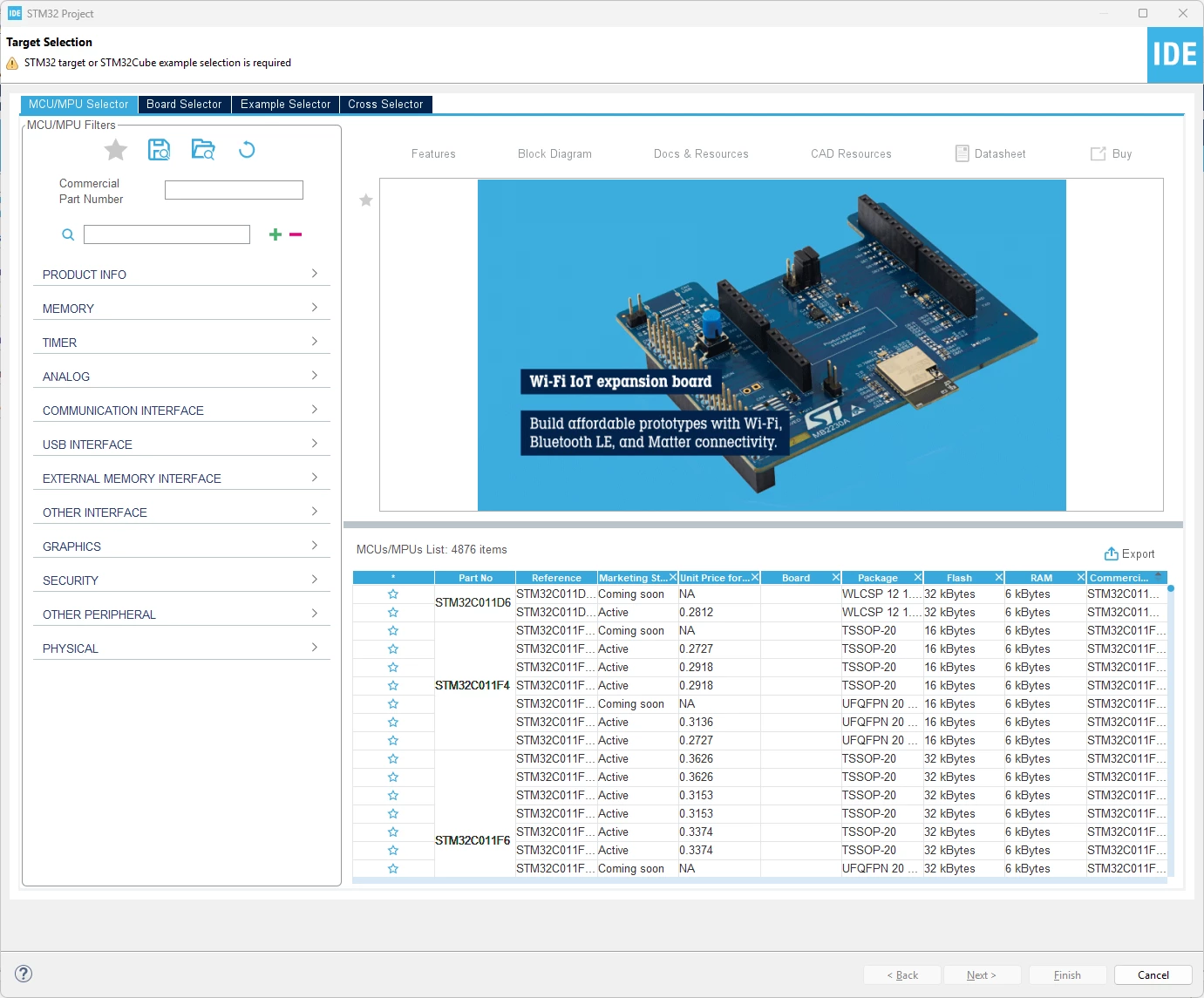

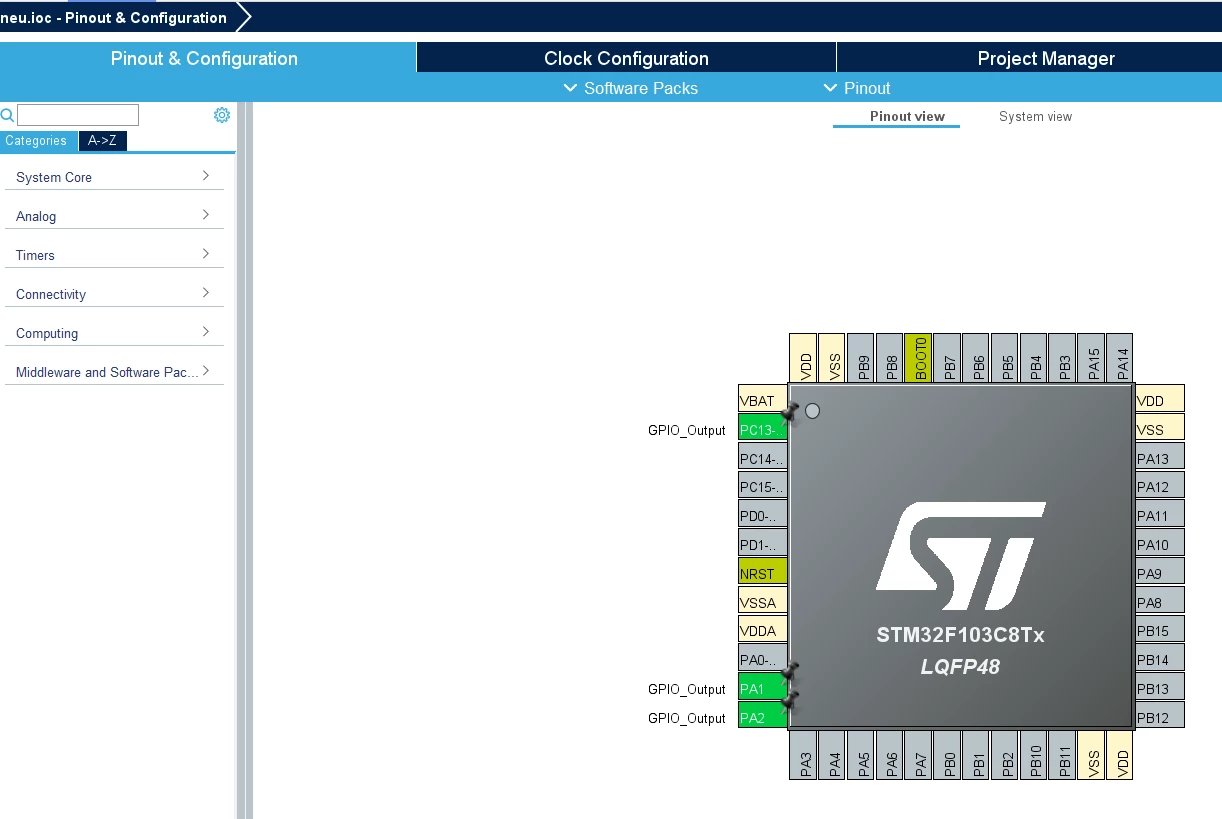

Where is the target board selector in 2.0.0
Hello
If I use CubeIDE 1.19.0 there was a target board selector after starting a new project. In 2.0.0 I can not find it. Slso the GPIO config.
What happens?

Hello @blafusel
In the latest release , STM32CubeMX is no more integrated in STM32CubeIDE 2.0.0
For more details , please check this STM32CubeIDE 2.0.0 released
 To download CubeMX standalone please use this LINK
THX

Andrew Neil
Dec 23, 2025 11:08 AM UTC
As @Ghofrane GSOURI already said, this is no longer integrated in the IDE - you need to use the standalone CubeMX tool.
See: STM32CubeIDE 2.0.0 New workflow tutorial
For explanation & discussion, see: IDE Version 2.0.0 - why remove MX ?
