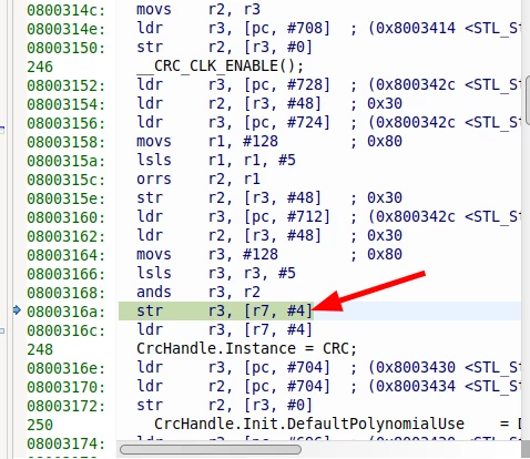

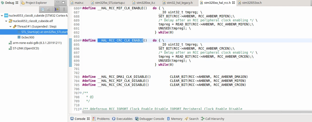

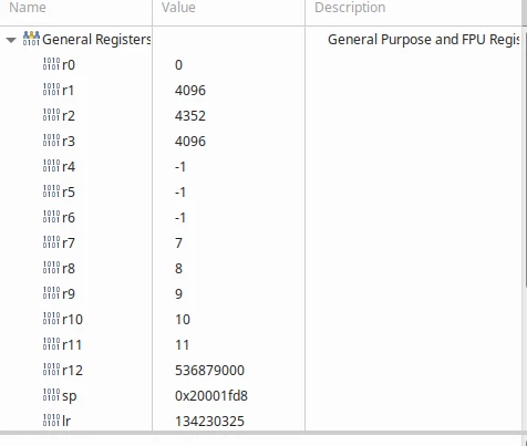

I've returned to this task and tried to run the Example project from 2.2.0 CLASSB library version.
For that needs i've reintegrated STM32L0xx_Nucleo for Nucleo-l053r8 board to CubeIDE where i'm suposed to run my main project and integrate this library.
But now i'm facing the issue:
After  control_flow_call(CRC32_TEST_CALLER) in STL_StartUp function on line 238 of example stm32fxx_STLstartup.c file i'm running into HardFault_Handler() with unknown for me reason.
1) I've tried running simple elf file, generated by the project, running project_CRC.hex file generated by bat file - but all of them stops at the same place.
2) Tried also to run from LSI/HSE, disabling IWDG, WWDG tests - all of it doen't help.
Can you please provide some recomendations on how to debug this error.
Current state of project on github: https://github.com/Mukhin22/nucleol053_classB_cubeide
P.S. is it possible to debug the .hex loaded file using standard debugger of CubeIDE(1.11.0)?
Thank you:)
Petr Sladecek
January 10, 2023
as you can see from definition
/* Exported macro ------------------------------------------------------------*/
#define init_control_flow() CtrlFlowCntInv = ~(CtrlFlowCnt = 0uL)
#define control_flow_call(a) CtrlFlowCnt += (a)
#define control_flow_resume(a) CtrlFlowCntInv -= (a)
there is nothing more than quite simple servicing content of the "Class B pair" of variables dedicated to check the program flow. As the same macro has passed correctly already at line 197, there should be nothing wrong with allocation of these variables.
The L0 FW (v2.2.0) is quite obsolete, are you sure you have applied all the suggestions summarized at chapter 3.10 of the AN4435 concerning protection of the preserved CPU registers especially?
Hard fault is fatal error usually connected with some wrong memory access via corrupted pointer (e.g., overwritten CPU register). I suggest switching into disassembly window and trying to understand which and why concrete instruction fails.
Rgds,
Petr

I've tried to debug it with instruction stepping and disassembly: here is what i've got
i'm dropping on str r3, [r7, #4]
what i believe must mean to store the register r3(4096), on address offset base- r7(7), address offset value 4
kinda strange address and value, don't know where to proceed with debugging, maybe you can help?
i've attached pictures of disassembly, gen registers and macro that is in fact called in code
