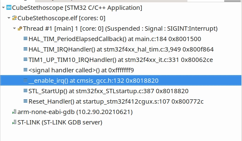

@Petr Sladecek​ now i'm facing another issue on my main CubeIDE project on F412, where i'm trying to integrate the library (also 2.2.0) - i was writing about it in my first messages on thread.
I'm successfully pass 3 parts of startup tests with such messages:
******* Self Test Library Init *******
 Start-up CPU Test OK
 Start-up FLASH 32-bit CRC OK
 Control Flow Checkpoint 1 OK

After __enable_irq() command i stuck in TIM1 time base source timer interrupt forever:0693W00000Y8F0mQAF.pngI saw in AN4435 that it is possible to have conflicts with "user application" interrupts, but i can't see some recommendation for solution of such a problem.
I was trying to use HAL_SuspendTick before and after enable_irq, but it doesn't help as i understood it anyway enables interrupt and it will be triggered right after enable and stuck in that interrupt forever.
NOTE: Also if i will use step by step passing of the TIM1 interrupt through debugger stepping it will return from it (idk why). And than jump again to TIM1 handler and stuck if i resume debugger in Startup_Copy_Handler().
So can you recommend something to handle such a problem with tick interrupts?
AMukh.3
AMukh.3Author
January 15, 2023
As well as i understood this TIM1 is triggered as freeRTOS tick handler (because i have FreeRTOS middleware added to project). It is inited in HAL_InitTick function during startup tests.
And if i reconfigure HAL_InitTick function to work with SysTick_Handler at start the tests stop to stuck in TIM1 interrupt handler forever. I'm planning to enable this timer after the HAL_Init already in main function, not in startup stage...
Is this workaround is normal in that case ?
Petr Sladecek
January 16, 2023
Note all the modification of the assembly startup file forcing an early call of STL_StartUp during standard C-level initialization is very drastic modification with potential of corrupting this process (manly due to RAM area content destroyed overall by the RAM self-test). Any attempt to recover the destroyed RAM content at main is strongly dependent on compiler behavior during C-level initialization (here at the example is rather focused to restore RAM data necessary to continue at some debugging functionalities like recovering UART verbose mode and LED blinking). I'm not expert of freeRTOS but suppose its RAM data recovery would not be quite trivial. That is why whatever initialization of such a FW performed after RAM full test (done later from main loop at best case) would be better and safe. Be careful, SysTick handler is used for handling partial steps of the STL run time test, too (see stm32f4xx_it.c file). Maybe you should solve this conflict as well when combine STL with the RTOS.
Rgds,
Petr

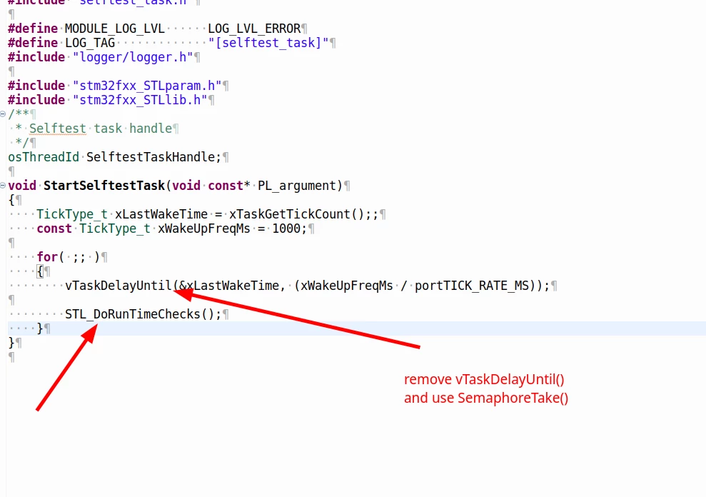

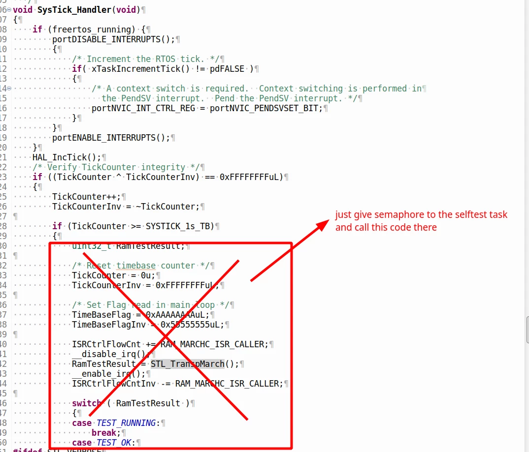

January 19, 2023
Thank you for your consultations, @Petr Sladecek​
I've managed to setup it all, without damage to my application logic.
One more thing that i wan't to ask, if it is possible to move the systick_handler called STL_TranspMarch() test to the my application part, to not use the interrupt context for a long time?
I'm thinking about doing it with the semaphore in the following way:
0693W00000Y8fvUQAR.png0693W00000Y8fvjQAB.pngAs well as i can see this should not break the XCUBE-CLASSB library logic.
Petr Sladecek
January 19, 2023
Of course, it is not necessary to perform calls of run partial ram test steps from here but be careful the interrupts must be masked during its execution (associated RAM content is destroyed during the partial step) and take care about control flow handling, too.
Rgds,
Petr
