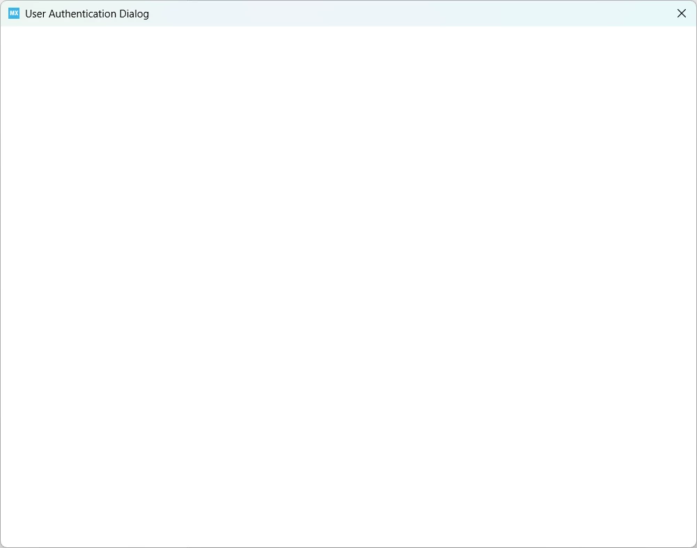

User Authentication Dialog hangs
The newest version of CubeIDE requires a sign-in to myST, but the dialog box hangs on Ubuntu.  Pretty frustrating...

    I'm struggling to log in with the myST link as well - I have Version 1.15.0, on a Windows 10
    Graduate
    May 14, 2024 8:28 PM UTC
    I cannot login to my-ST as well, I get stuck on User Authentication Dialog forever, with the lines bumping as if it was loading.

    Issue still ongoing over a year later, and seemingly not just Linux(?)
    I'm running STM32CubeIDE v1.16.1 on Windows 11, same issue: User Authentication Dialog window pops up (after 10-20 seconds of "Loading, please wait"), vertical lines bumping across, but never gets anywhere.  Tried around a dozen separate times, waiting a couple minutes minimum each time, nothing.
    I expected having to wait after entering in my credentials, but it's ridiculous for a login window to hang on initial load of the window itself.
    FYI, in Window > Preferences > STM32Cube > Firmware Updater, Check Connection verified a good connection.  In Window > Preferences > General > Network Connections, I've tested this with Active Provider at default settings and changed to Manual, same result.

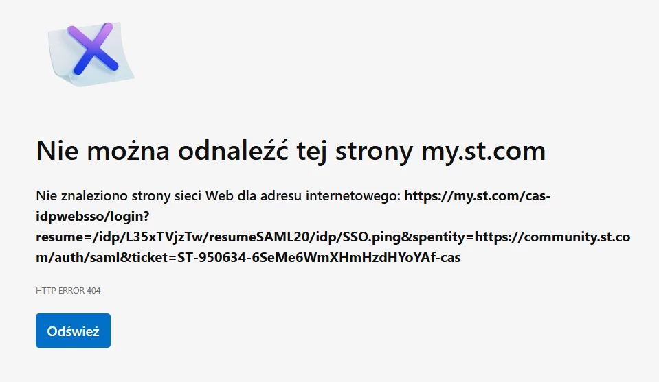

    Visitor II
    Mar 4, 2025 1:29 PM UTC
    Has anyone managed to solve the problem?
    For 1.18.0 I can't still log in and I can only see empty window.
    I think that the problem may be on ST's side because several attempts to log in to the forum were also unsuccessful.
