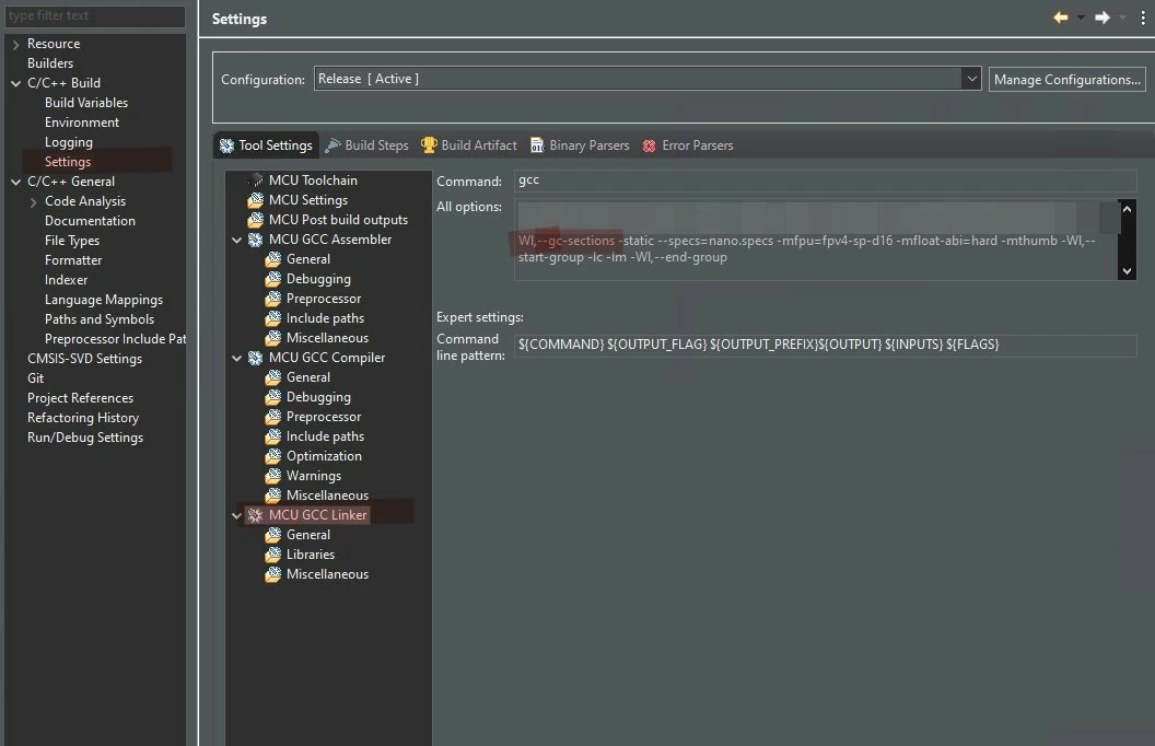

July 2, 2024
Many thanks for your replies.
It's true that my variable is being pruned away by the linker but why? That's my question. All the sources cited suggest this should not happen.
In @AScha.3's reply, it says: "will include it in object file (and linked executable)"
Also the ARM doc URL cited says:
"Data marked with __attribute__((used)) is tagged in the object file to avoid removal by linker unused section removal."
In both cases the effect in bold above is not being realised. The point of this attribute is to ultimately override unused section removal in the linker. If it's only partially effective in the toolchain it might as well not be supported at all.
Note that exactly the same source code in a different compiler toolchain (TI Arm Clang) has the desired effect even when unused section elimination is switched on.
I tried to use 'retain' but this is actively ignored (not supported?) by the compiler.
I conclude so far that I'm using it correctly and the expectation that it shall survive linker pruning is legitimate. The problem remains, however, why it's not happening in this case.

BarryWhit
Lead
July 2, 2024
Sigh. So there seems to be some disagreement about the semantics of used. Some say it means it should be emitted to the object file (but may be prune by linker gc options), and some some say it should remain the the final elf.
Please see this SO answer, which suggest what you want is actually the "retain" attribute.
The gcc documentation suggest this is correct (at least when the attribute is applied to functions):
retain
For ELF targets that support the GNU or FreeBSD OSABIs, this attribute will save the
 function from linker garbage collection. To support this behavior, functions that have
 not been placed in specific sections (e.g. by the section attribute,
or the -ffunction-sections option), will be placed in new, unique sections.
This additional functionality requires Binutils version 2.36 or later.
The way I explain my way out of this bowl of spaghetti is:
1. An unreferenced static (i.e. file-scoped) global variable will be eliminated by the compiler if (Certain) optimizations are turned on.
2. ...Unless the the variable is annotated with the "used" attribute, In which case it will be included in both the object and the final elf file.
3. ...Unless you specifically ask the linker to gc unused sections  (and used -fdata-section during compilation),
 in which case the variable will not be included by the linker in the final output elf file.
4. ...Unless you annotate the variable with the "retain" attribute, in which case the linker GC will skip over the variable, and it will be emitted in the final elf file.

KierAuthor
July 9, 2024
ST support mentioned that KEEP is needed in the linker script but have not acknowledged that this works without the used attribute. On the one hand there is a solution but on the other, the assertion in the title still holds true. 'used' attribute Appears Ineffective.
It looks like its only benefit is to document variables in the source that one intends to bypass unused section removal. In addition, if the same source (with 'used' attributes) was ported to a toolchain that did support 'used' (e.g. TI arm clang) it would not need further linker instructions. So for these reasons it is probably better to keep the 'used' attribute even though it doesn't do anything useful in the STM scenario.
BarryWhit
Lead
July 9, 2024
But it's not ineffective. It works as intended. You're compiling with -fdata-sections and --gc-sections, so you're explicitly asking for the variable to be pruned. You can't blame the toolchain for doing exactly what you're asking it to do, and you can't call the attribute ineffective because of it.
 >  In addition, if the same source (with 'used' attributes) was ported to a toolchain that did support 'used'
This would surprise me. Have you really tested this claim against TI's compiler (with the same options compiler/linker)?
Because from what I understand, other compilers would behave in the same way. i.e. specifying --gc-sections explicitly asks the linker to ignore the used attribute. If the `retain` attribute is not available, manually adding a carve-out in the linker script is probably the best you'll get.
It's also possible (untested) that you could get what you want by using the `section` attribute instead.
If you manually place the variable in a section that contains any other used variables, it should not get pruned.
Also, the use case you gave earlier was that of a version string kept a fixed memory location in a bootloader. But there would be no need to make the variable static in that case (in fact, exporting it as a symbol would be good documentation), and you could not get it to be at a known fixed location with manually manipulating the linker script, anyway.
