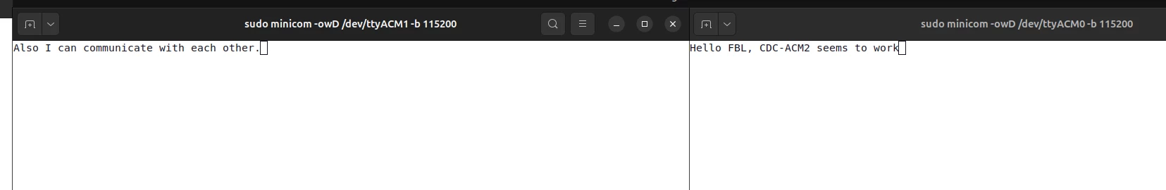

Sep 9, 2024 12:28 PM UTC
Hi @FBL
I followed one of the blog posts and got it working.
Seems like when UART is echoing, it doesn't work as expected.
