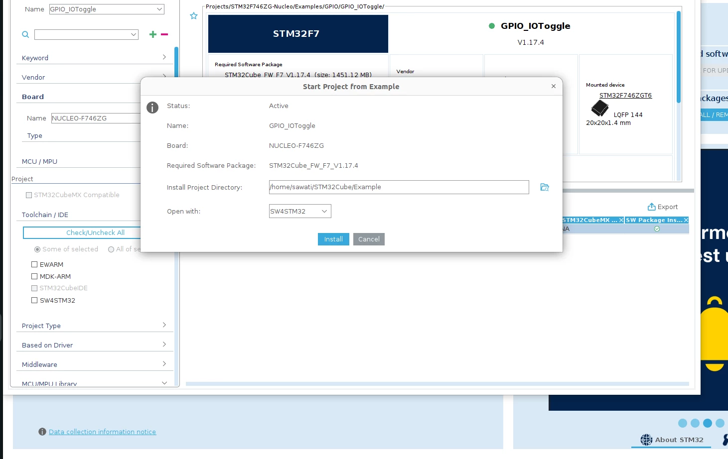

Unable to import examples which stm32 provided for reference .
Above image you can see in toolchain option STM32IDE is disable . also i am facimng issure i =n import examples which stm32 provided for reference . you can also refer my shared video.

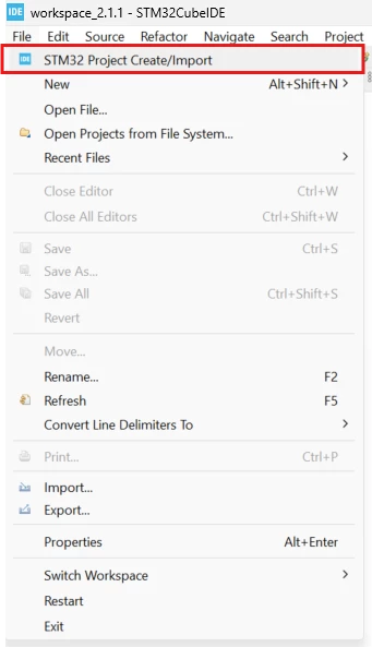

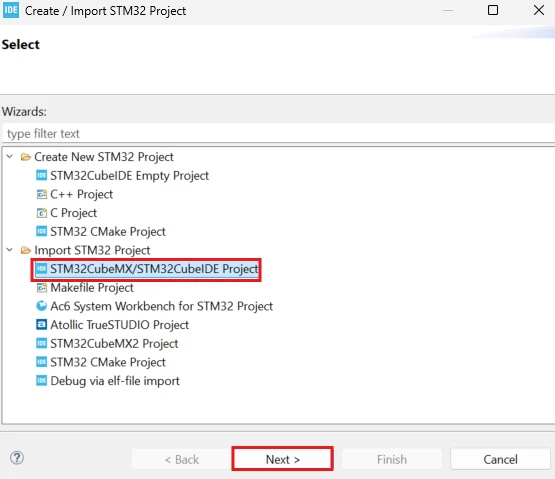

Hello  @shreya_awati
Open STM32CubeIDE 2.1.1.
Right Click on File, then click on STM32 Project Create/Import :
Thanks.
Mahmoud

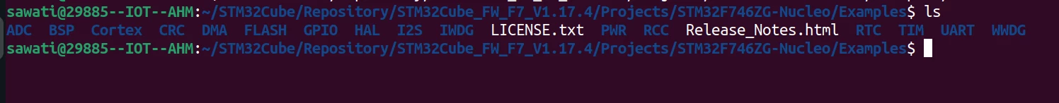

Yeah, it doesn't just work for the F7 series. Seems ST haven't taken the effort to update the example selector for that series and the SW4STM32 conversion has apparently broken over time. Shrug. The files are all there. You could create a new project for that chip and copy them over, but it would take some effort.
August 22, 2026

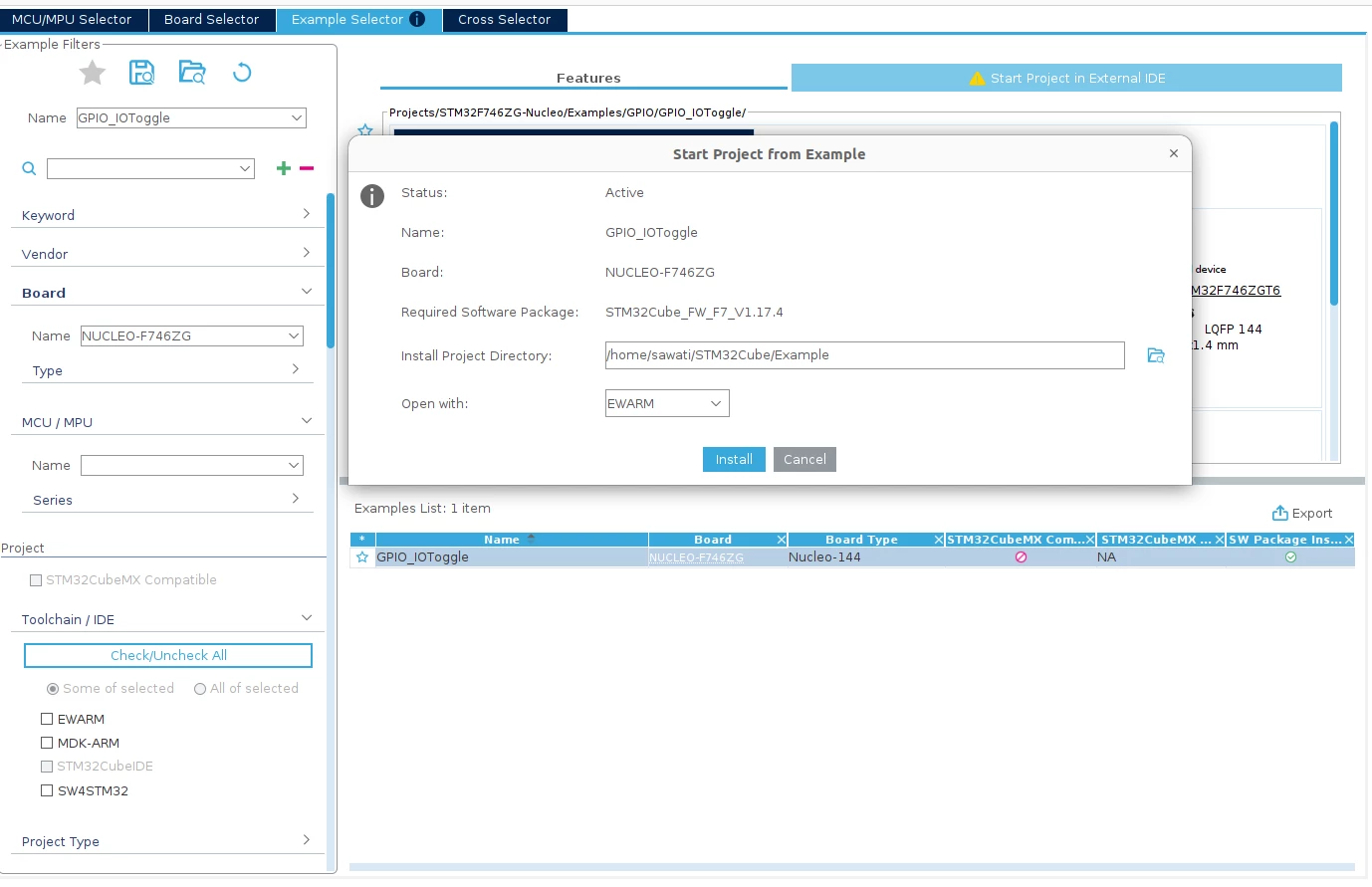

Use the Example Selector in STM32CubeMX for the easiest way to load examples.
> another example
Be more specific.

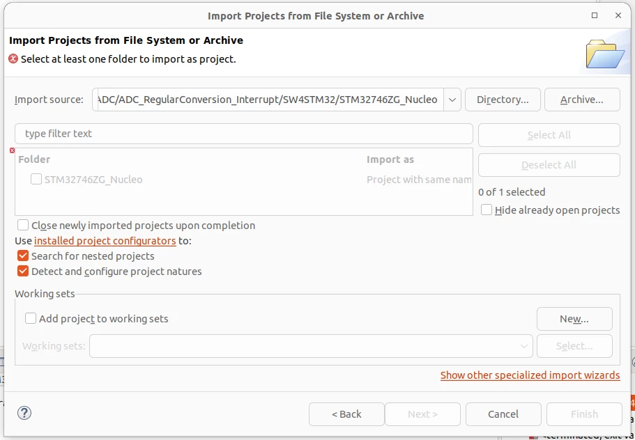

August 22, 2026
which path i can select for "Install project directory" . what is meant we are import examples from software package examples or it is location for store example .
For open with option i am not able to see STM32IDE , only below options are available.
SW4STM32
EWARM
MDK-ARM
Explorer
. please give me steps from scratch.
It is where you want to create your copy of the project. The original (source) is in the MCU firmware package in the Cube "repository".  [To remind - the project directory path must NOT contain spaces and weird characters in any subdirectory.]
If the CubeIDE option is not available: select SW4STM32. After CubeMX finishes its magic, use CubeIDE to import the project with conversion from SW4STM32 format (they both are different flavors of Eclipse CDT).
Pavel A.
August 22, 2026
Try exporting for SW4STM32, then convert by CubeIDE project import.

which version of IDE you using . i am using MX is 6.17.0 and IDE is Version: 2.1.1
I am importing package from MX for F7 latest . In image you can see package is successfully installed .
Please tell me in detail steps how can i import .

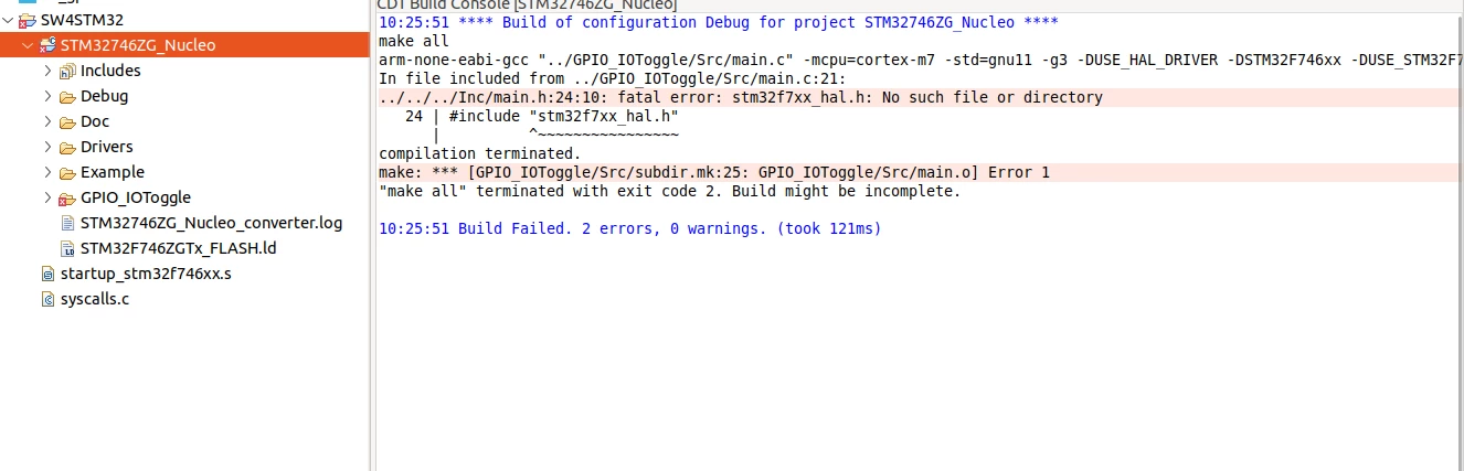

git this error.
Pavel A.
August 22, 2026
Hmm. As  @TDK commented, conversion from SW4STM32 is not perfect. Looks like you have to check and fix include paths and other project settings after conversion. This may be, unfortunately, too confusing for a beginner, and you may use some help.
For a simple project such as GPIO blinky, better create a new project with CubeMX (or CubeIDE 1.9) or find existing example for CubeIDE.

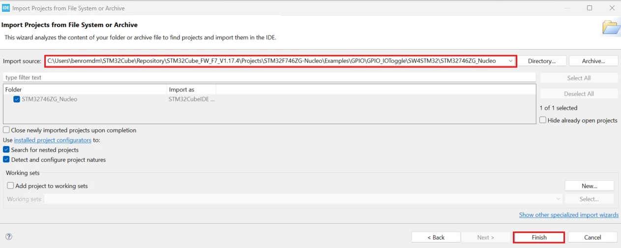

Hello  @shreya_awati
Thanks.
Mahmoud
August 22, 2026
Its working fine.
Thanks

AI tool such as Github Copilot or Claude Code can be asked to fix include paths in CubeIDE project.
