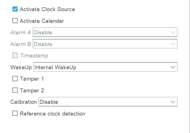

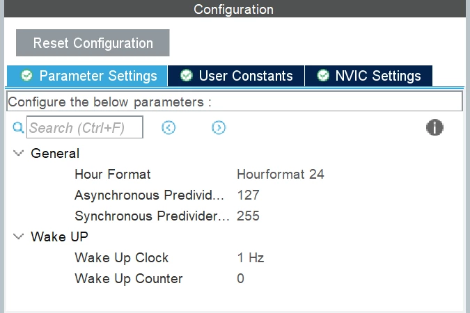

Unable to get RTC interrupt with STM32L476.
Hello!
I am trying to get interrupt on each second using STM32L476 RTC module.
I am configuring RTC module using cubeMX.
RTC module interrupt is enabled, but there aren't any interrupts from RTC?!
Would you please advice!

    Hello @LMehm ,
    I recommend you, when you configure the RTC, to follow the steps shared in this FAQ: How to configure the RTC to wake up the STM32 periodically from Low Power modes.
    In this article we will see how to configure the RTC peripheral of the STM32 to wake up the STM32 periodically from a low power mode like STOP2 mode which is one of the lowest power modes of the STM3L4.
    Also, I advise you to take a look to this wiki: Getting started with RTC.
    This article explains how to use the RTC. It provides code examples to use RTC Alarm with interrupt with NUCLEO-L476RG board.

    For the simplest example of a "once per second" alarm, the article presents the worst approach with an unreliable implementation - the code reconfigures the alarm every second and, if this code is interrupted for more than a second, then the alarm stops working at all.

    if you just want to get interrupt every each second by RTC.
    you can use Alarm mode and enable all mask in alarm setting but this function require a calendar.
    but if you want it wakeup that you have to make sure it's in sleep mode.
