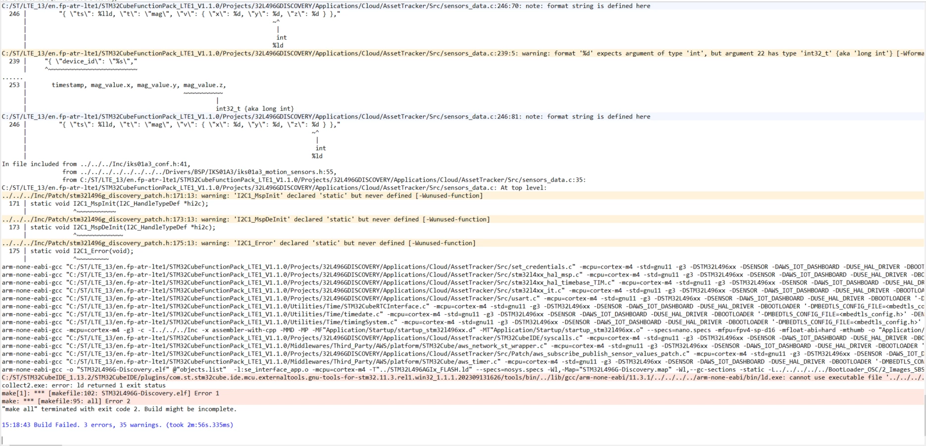

As mentioned in the doc "FP-ATR-LTE1" the project was built using Cube 1.5.1. So I have also tried the same version. I am unable to understand if the build is happening as the binaries are being generated but saying the build has failed. Attached the image. Kindly let me know. Thanks and regards.

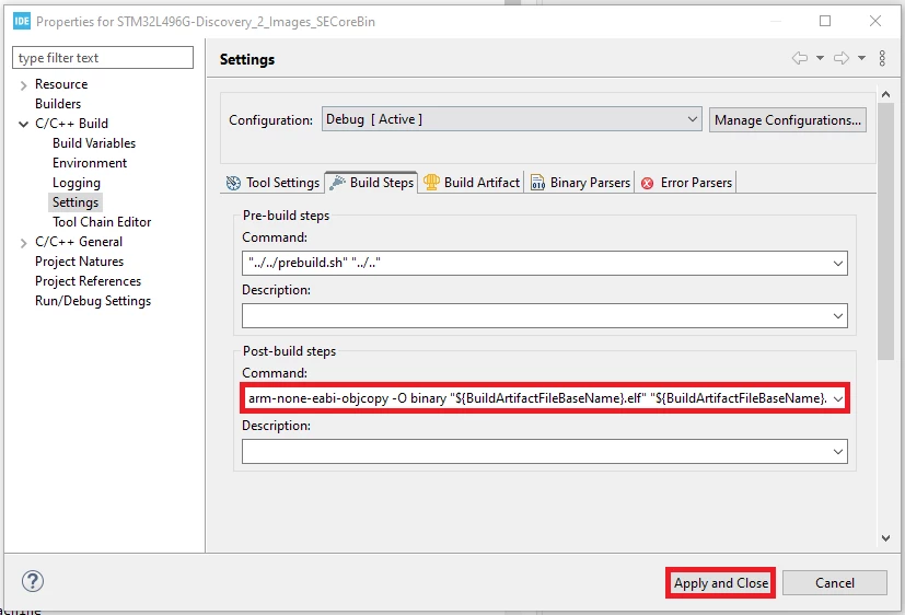

Could you please follow these steps to solve the issue:
1- Install the STM32Cubeprogrammer from https://www.st.com/en/development-tools/stm32cubeprog.html and try again.
2- Set the Post-build steps in Properties > C/C++ Build > Settings:  arm-none-eabi-objcopy -O binary "${BuildArtifactFileBaseName}.elf" "${BuildArtifactFileBaseName}.bin" && arm-none-eabi-size "${BuildArtifactFileName}" as shown in the below figure:
Then Build the project.

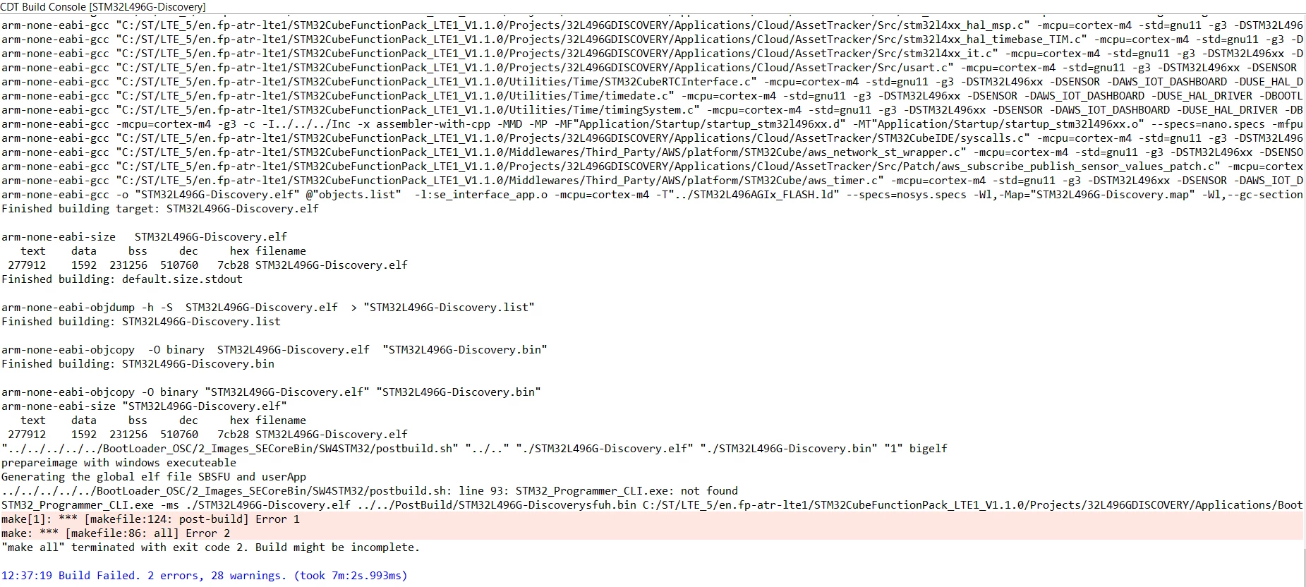

I am still getting the issue. I have attached the screenshot. I have exactly done what you have suggested. Kindly let me know what can be done I will do it as you suggest. Thanks and regards.

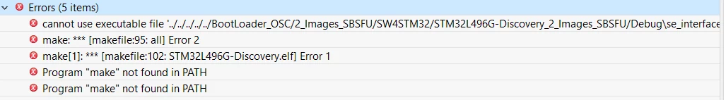

KDJEM.1
Oct 30, 2023 12:58 PM UTC
Hi @PSaga.1 ,
I think you have an issue with another project which is "\en.fp-atr-lte1\STM32CubeFunctionPack_LTE1_V1.1.0\Projects\32L496GDISCOVERY\Applications\Cloud\AssetTracker". I will check. Note that this project was built using STM32CubeIDE 1.5.1.
But firstly, could you please confirm that the build errors are solved for:
-\en.fp-atr-lte1\STM32CubeFunctionPack_LTE1_V1.1.0\Projects\32L496GDISCOVERY\Applications\BootLoader_OSC\2_Images_SECoreBin project when using the steps shared in my last reply.
-\en.fp-atr-lte1\STM32CubeFunctionPack_LTE1_V1.1.0\Projects\32L496GDISCOVERY\Applications\BootLoader_OSC\2_Images_SBSFU project.
Thank you.

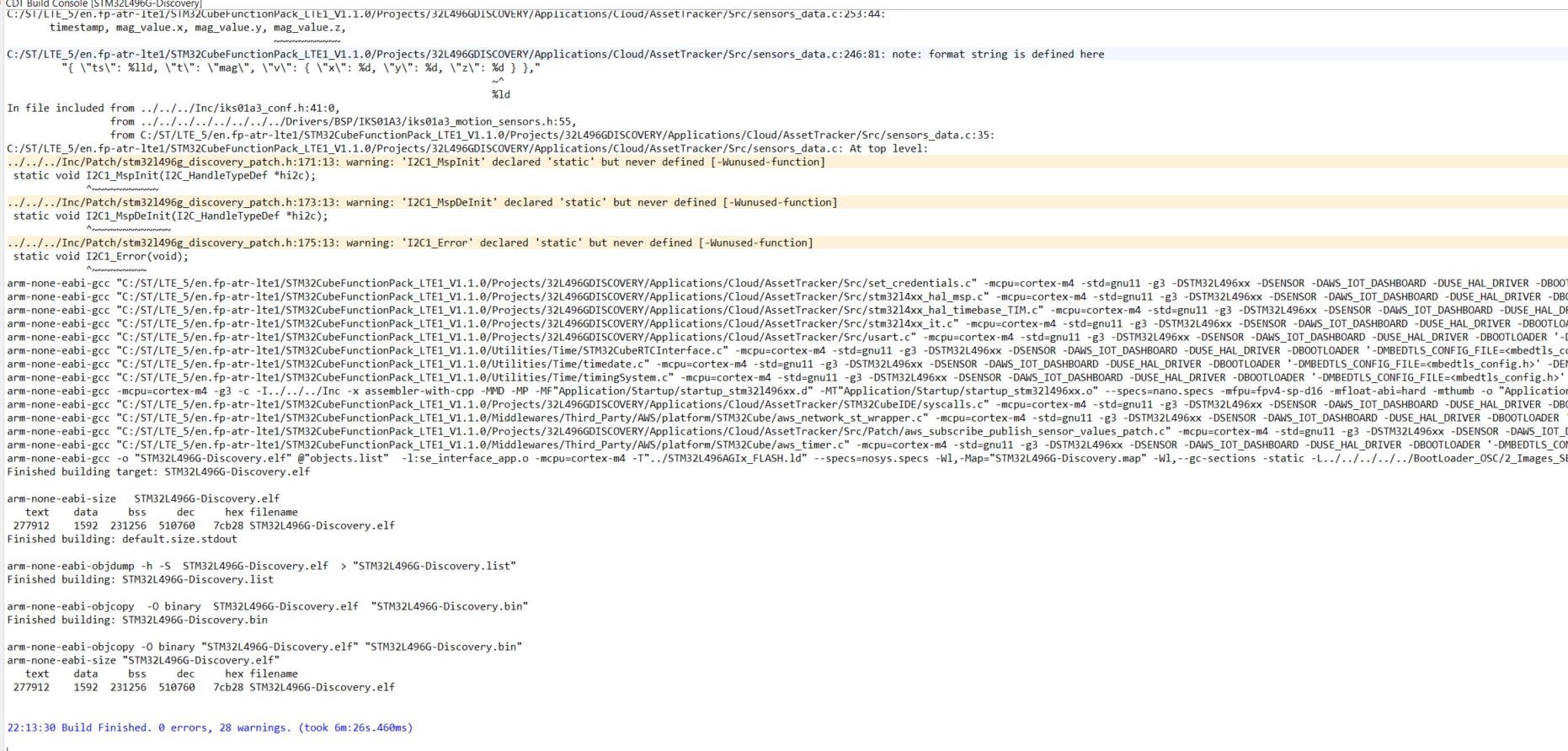

PSaga.1
PSaga.1Author
Oct 31, 2023 9:01 AM UTC
Hello Kaouthar,
The changes you mentioned has resolved the issues for 1.5.1 but not 13.1. I have attached an image for reference. Now I can get started with the project. Thanks and regards.
