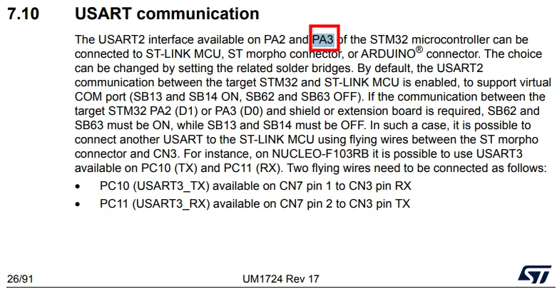

Struggling to set pins to high on NucleoF411RE
EDIT: Solved. It seems to just be that one pin that isn’t working. I tried a couple other ones and they work fine.
Hello, sorry if this is a silly question, but I'm pretty new to all of this. I've recently picked up Israel Gbati's Bare-Metal Embedded C Programming. It gives a step-by-step walkthrough on how to turn on an LED using pin D12/PA5, but I'm struggling to connect to any of the other pins.
I've been trying to connect my LED to pin D0/PA3. My code is below.

I've been searching through the documentation but nothing has stood out to me. I figure that I've made some silly little beginners mistake and someone here would be able to catch it. Does anyone know what I've done wrong?

Rather than edit the opening post, it would be more helpful to put that in a Reply, and then mark that reply as the solution.
Did you check the User Manual and/or schematics to see if that pin is actually used for something on the board?
https://www.st.com/resource/en/user_manual/um1724-stm32-nucleo64-boards-mb1136-stmicroelectronics.pdf#page=29
via: https://www.st.com/en/evaluation-tools/nucleo-f411re.html#documentation
