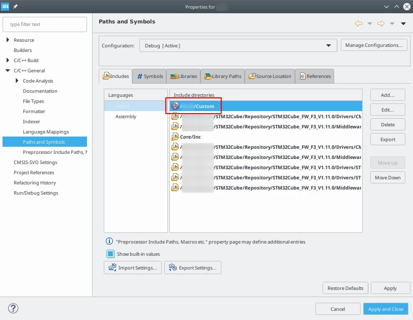

My current workaround is to copy the _hal_conf.h file to some other directory, modify it to my liking and add its path to the top of the Include directories list. I also needed to set the Is a workspace path option to keep the code generator from changing its order.
Obviously, when you're doing any major reconfiguration (enabling/disabling peripherals etc.) you need to manually update your customized variant, which isn't ideal.

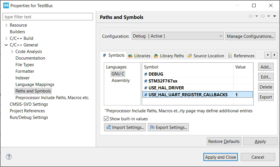

You can enable callbacks by defining the macro USE_HAL_UART_REGISTER_CALLBACKS in the Project->Properties dialog:
KnarfB
Aug 8, 2020 6:02 AM UTC
At least not in recent versions of STM32CubeIDE. It will be redefined by generated code as described above.
JThat.1
Visitor II
Aug 8, 2020 6:23 AM UTC
I'm using CubeIDE 1.3.1 and setting the symbol above allows me to use HAL_UART_RegisterCallback() to register callbacks and is working fine. Maybe it depends on the specific target or options selected in CubeMX.

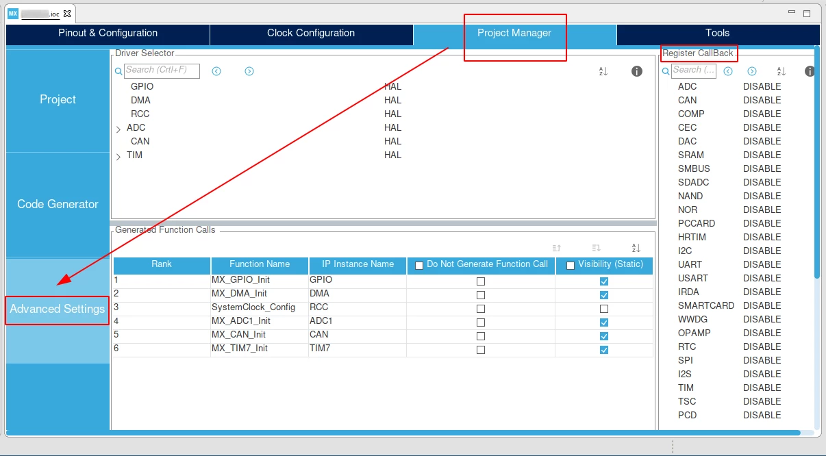

Aug 10, 2020 12:45 PM UTC
It's and old topic, but today i stumbled upon STM32CubeMX Project Manager > Advanced Settings > Register Callback where those settings can be configured.
TPeča.1
Aug 26, 2020 3:32 PM UTC
This feature has also been added to STM32CubeIDE 1.4.0 now.
Do note that the Register Callback pane might be obscured, you need to scroll right inside the device configuration window.
