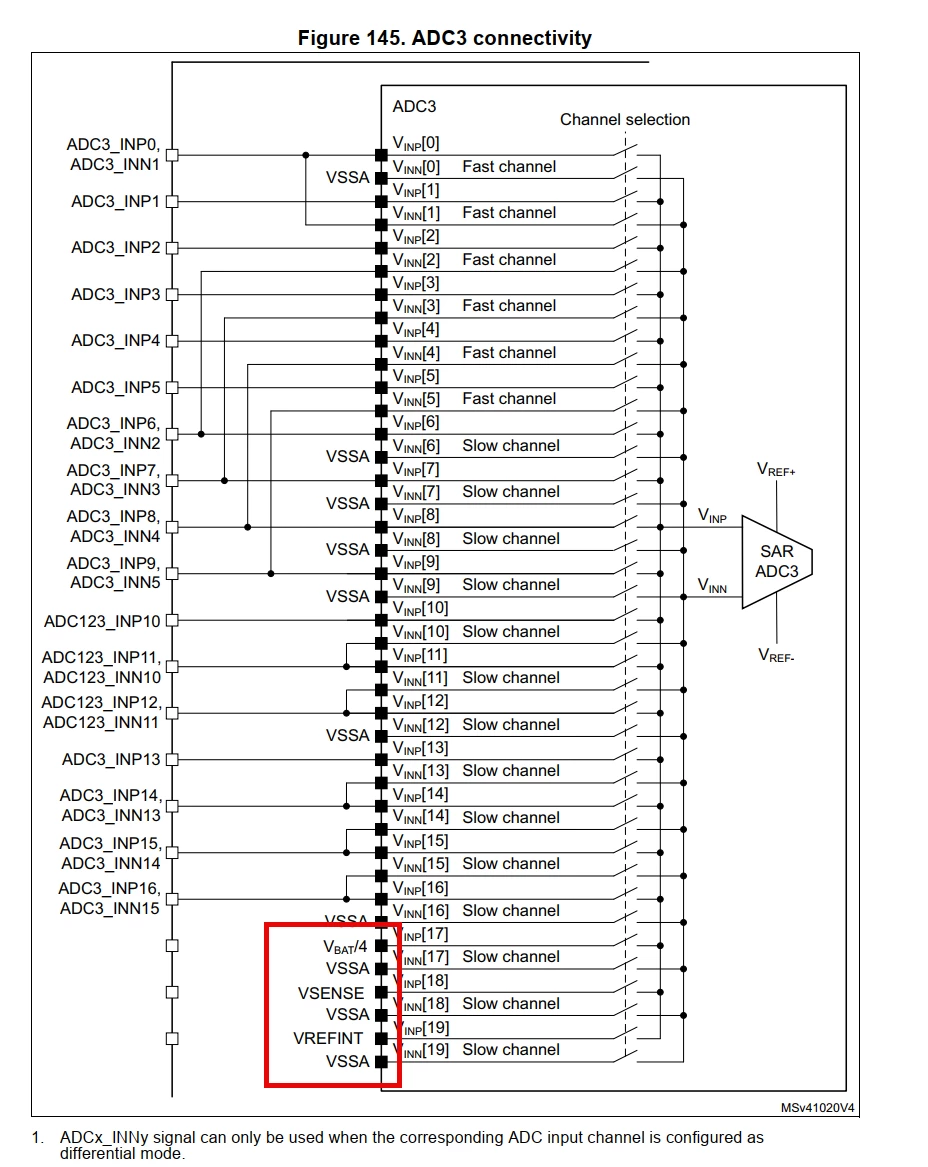

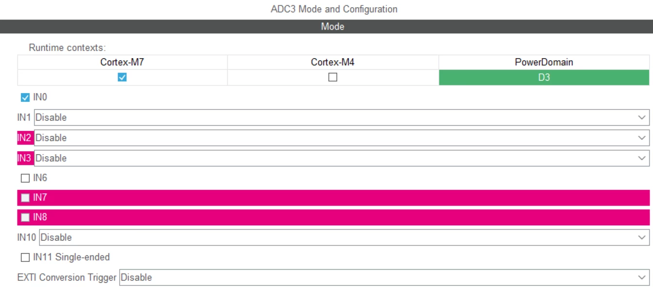

Hi Guys,
In datasheet, there are 20 channels, inlcluding Vbat, Vsense, Vrefint. But I can not find them in CUBEMX configuation page, why?

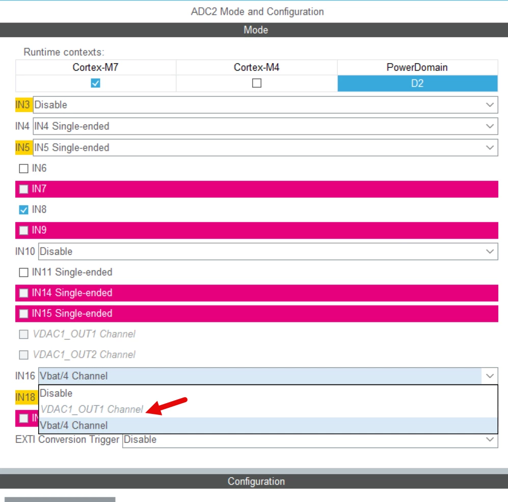

Peter3718Author
May 16, 2024
By the way, I found Vbat in ADC2 page, which is not supposed to be here according to datasheet.  Others still can't be found.

mƎALLEm
May 16, 2024
Hello @Peter3718
For ADC3 This is a known issue already raised in this thread and already escalated for fix in the internal ticket 176638.
