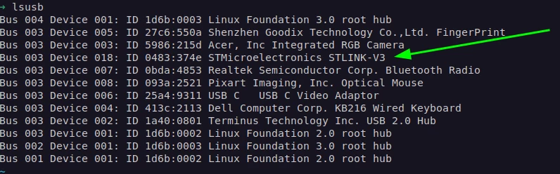

Hi Support
I have experience in STM32 with Zephyr but I am trying out AMP for the first time.

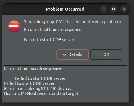

So I am trying out OpenAMP example from STM32CubeIDE. I can compile the example but cannot flash the same.
I have the following error
The ST-Link device is present as shown below
I have tried other boards like NUCLEO-G431RE with some simple UART example and work well.
I have problems only with AMP board, I am not able to flash M4 and M7 core.

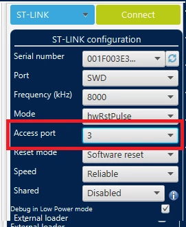

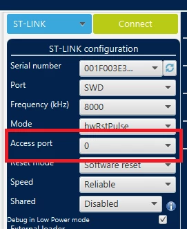

You need to ensure the connection step with CubeProgrammer.
You need to ensure the connection to each of the Cores CM4 and CM7:
To connect to CM7, you need to set the access port to 0:
To connect to CM4, you need to set the access port to 3:

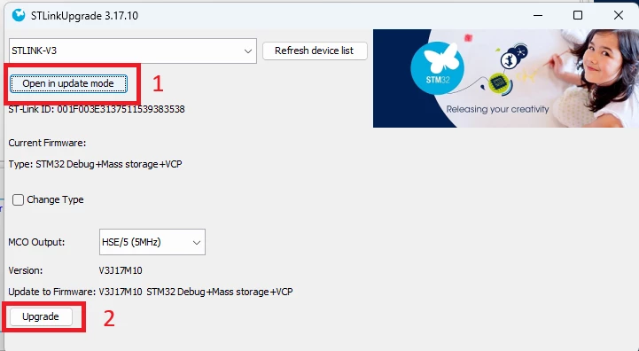

If you succeed to connect with CubeProgrammer, try to update the ST-LINK firmware with CubeProgrammer:
Then,

None of the example works for this particular board. I cannot flash into M4 or M7
mƎALLEm
Apr 9, 2026 9:05 AM UTC
What part of the project you cannot flash? CM4 or CM7?
mƎALLEm
Apr 9, 2026 9:18 AM UTC
You didn't answer my question. Which part of project is not uploaded? CM4? CM7 or both?
You have two projects inside the example.
jo512
jo512Author
Apr 9, 2026 9:20 AM UTC
I cannot upload both
