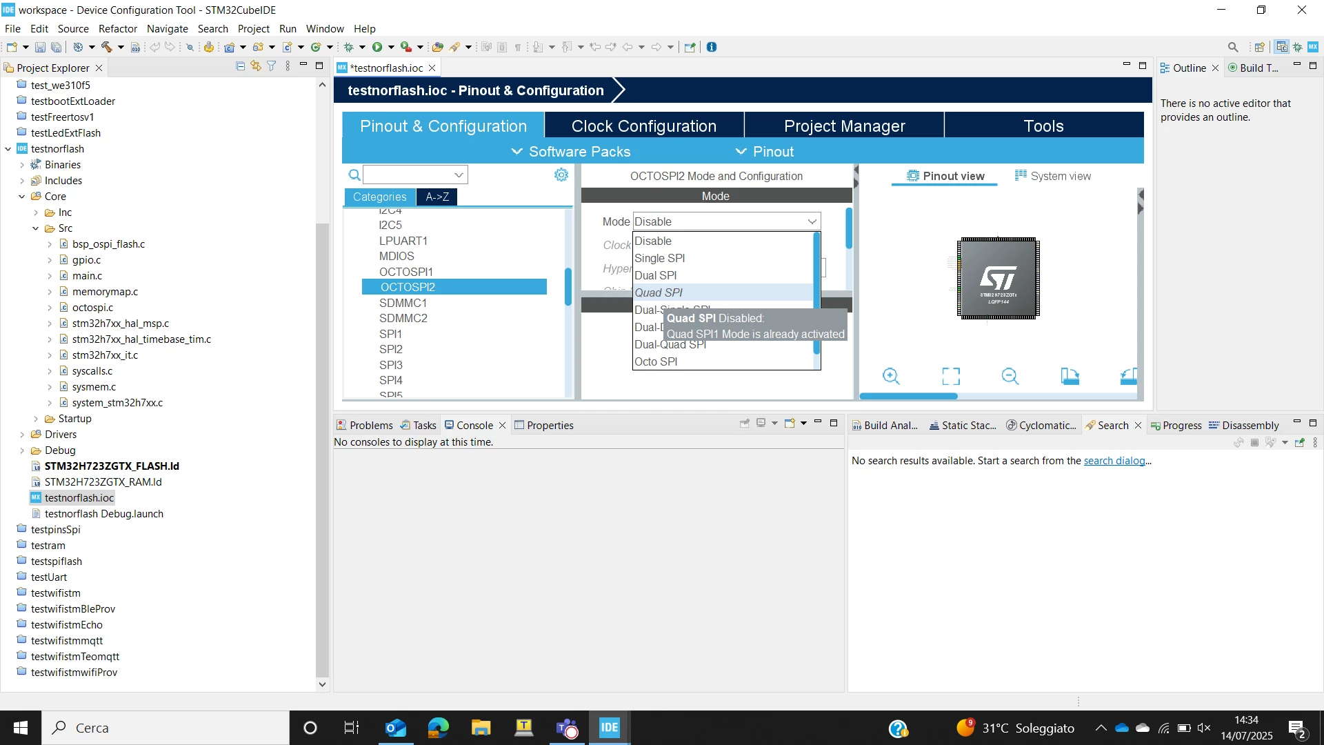

STM32CUBEIDE Version: 1.19.0 QUADSPI unavailable on STM32H723ZG
With the last versione of STM32CUBEIDE Version: 1.19.0 i can't configure the OCTOSPI as QUADSPI

Hello @franckngatcha ;
First of all thank you for posting.
Similar issue is reported here.
Internal ticket number is reported : 213708 (This is an internal tracking number and is not accessible or usable by customers).
I apologize for any inconvenience.

Hello @franckngatcha;
The issue is fixed in STM32CubeMX 6.16.0 version.
