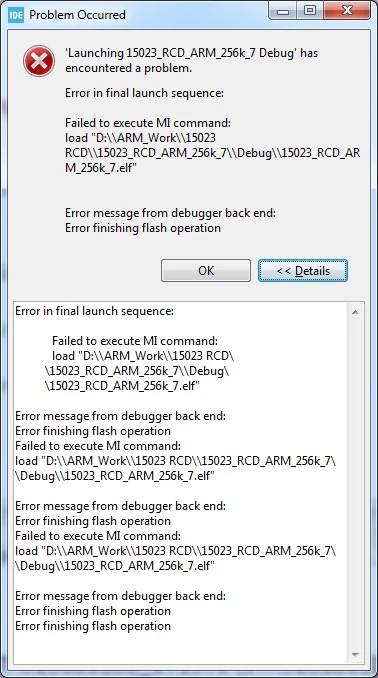

It seems V1.15 has more problems, i was working on a project the upgrade was ready i closed the project and did the upgrade. Then went back to my project. Now i cannot download my code for debugging, getting some very odd error message. Screen shot attached. I can still connect to the hardware using STM32CubeProgrammer no problem.
i would also suggest getting a STLINKV3. My old STLINKV2 will not upgrade under V1.15.
i was hoping some of the bugs and instabilities in the IDE would have been fixed now i cannot do my work. this i caused by upgrading.
