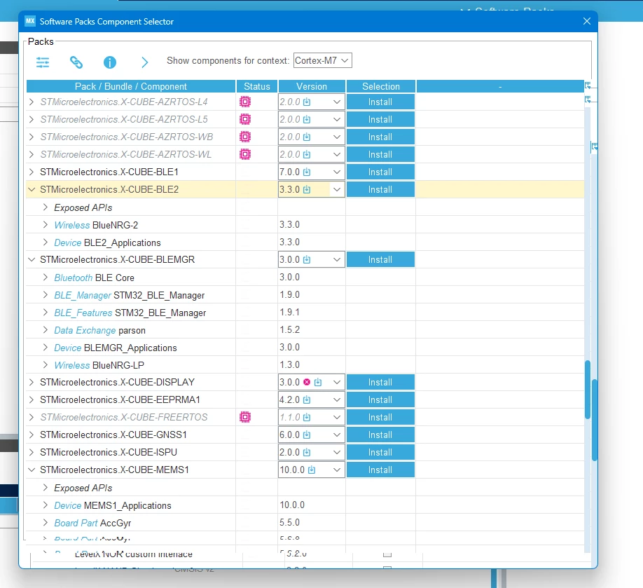

Something weird is going on my computer since a long while, but it gets very annoying as I work with more on this computer. If I open a .ioc file, or do anything in STM32CubeIDE that will bring up a non-eclypse dialog, the GUI misbehaves in a very weird way. Best example is if I go to Software Packs -> Select Components menu - it becames absolutely unusable, every time I open it up. I attached a file where you can see, how the window looks like after scrolling the list or open up a dropdown item.

  • If a dialog is distorted, resizing it will restore the dialog. But every time I interact something, it became distorted again. Continuously resizing helps, but not effective....
  • If two Select Components dialog is opened in two STM32CubeIDEs, the dialog, opened for the last, is working perfectly (please don't tell that hell yeah, this is the solution! :face_with_rolling_eyes: )

"The puzzled windows problem" is not really "new" , but afaik until now no solution by STM .
see:
https://community.st.com/t5/stm32cubemx-mcus/cubemx-ui-is-messed-up-again-again-and-again/m-p/580741
https://community.st.com/t5/stm32cubemx-mcus/cubemx-interface-bug/m-p/591221#M26001
https://community.st.com/t5/stm32cubemx-mcus/cubemx-6-8-1-application-gui-corruption/m-p/568694#M25272
...and many more .
Sometimes seems to help, if graphics text or icon size is changed; or using only one screen, if two been used.

bad news. I tried to play with text and graphics size, but it just get worse.
Anyway, thank you for your support!
