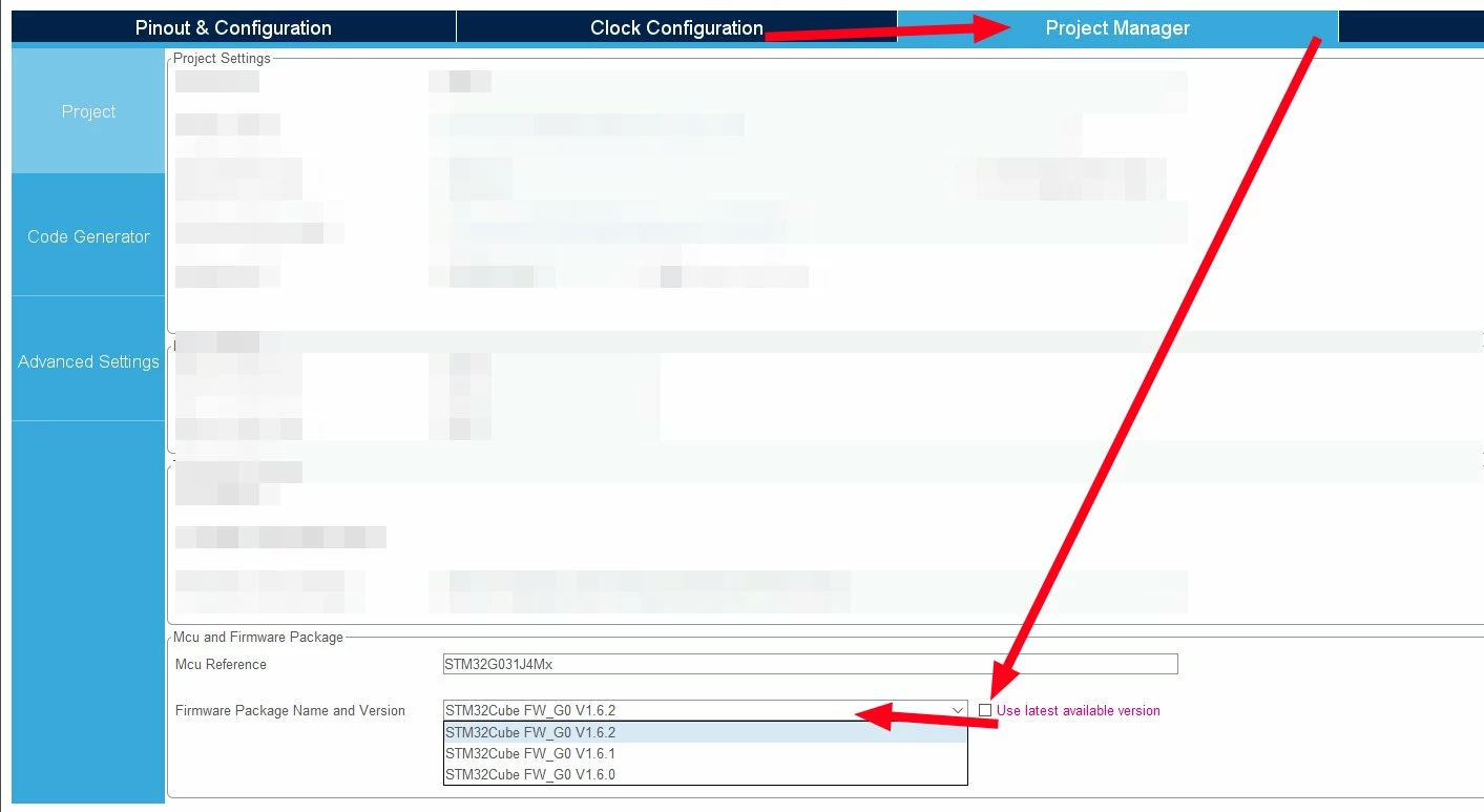

There's a version mismatch for the MCU package. Either go into the CubeMX properties pane and set the version to 1.11.0 (the default is to use the latest released version), or download the 1.11.5 patch zip from the website.
You can't install patch releases offline using the built in package manager, since they only contain changes relative to the base version. To install patches versions offline, you simply unpack their content to overwrite files in the previously base version directory, 1.11.0 in this case.

stameniAuthor
August 26, 2024
"Either go into the CubeMX properties pane and set the version to 1.11.0 (the default is to use the latest released version)..."
Can you please specify where the CubeMX properties pane is? I am new to this IDE, and I cannot locate it. And I think that might solve my problems.
BarryWhit
Lead
August 26, 2024
Actually, it's called the "Project Manager":
