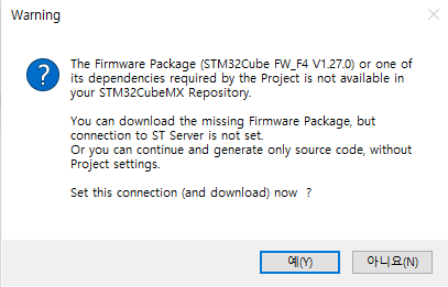

I am a STM32CubeIDE user. After installing STM32CubeIDE for the first time, run it to create a project, you will be prompted to connect to the Internet to download the package as shown in the picture below.
However, I need to participate in the competition with STM32CubeIDE, but I cannot use the Internet due to competition rules. So, you need to get the installation file of STM32CubeIDE to USB and download it. Is there any way to avoid the error in the picture below and download the package and STM32CubeIDE without internet??

It is rather rare to install STM32CubeIDE without the Internet, if only because a number of sub-packages may have been updated between release and installation.
Nevertheless, you can install the STM32CubeIDE without the internet, the error message only informs you that the required firmware package cannot be found. You can also provide it offline (e.g. download it on another computer and transfer it as a ZIP to the offline computer) and integrate it manually in the CubeIDE. You can find a few URLs to the websites for download here, the other ones are following the same structure:
If you manually unpack the firmware into the repository path before starting STM32CubeIDE, it can then also use this package as if it had been installed.
The default path to the repository, which you can change as you like, can be found under
Window > Preferences > STM32Cube > Firmware Updater
Does it help?

이정훈.1
March 16, 2022
Thank you.  Installation complete without internet. Thank you again.
