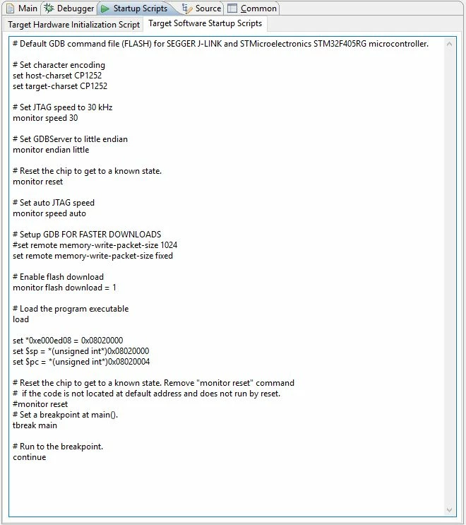

I used the following "Target Software Startup Script" in the debug configuration in Atollic TrueStudio (this is necessary since we're using a bootloader and our application binary which I would like to debug is not placed at the beginning of the STM32 flash):
How to enter this in STM32CubeIDE?
I would really need to debug my firmware, but can't figure out how to do the required settings...

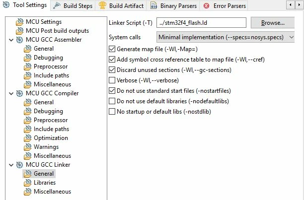

I just solved the issue...
It turned out that the linker setting "-Wl,--cref" (Add symbol cross reference table to map file) was missing. Checking the corresponding box in the linker settings, debugging now also works also with ST-Link in CubeIDE!

When I use e.g.
x Load image
Use project binary
x Load symbols
Use project binary
and under "Run commands":
set *0xe000ed08 = 0xC000
set $sp = *(unsigned int*)0xC000
set $pc = *(unsigned int*)0xC004
set *0xE0042004 = (*0xE0042004) | 0x7
tbreak main
continue

Jun 11, 2019 8:02 AM UTC
I have the above 3 commands in my initialization commands and it seems to run fine.
  • Can I check that if you don't have any of your initialization commands, your debugger connection is ok?
  • If you just put in the above 3 commands only, do you still face the same connection problem?

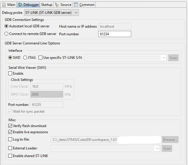

Jun 11, 2019 10:25 AM UTC
Your initial posts include some speed settings. I didn't have to do any speed settings for ST-Link to work.
Did you choose the Debug probe to be ST-Link?
MB_Inv
MB_InvAuthor
Jun 11, 2019 11:09 AM UTC
My last tests with SEGGER J-Link didn't include the speed settings.
I also tried with the same three initialization commands (yes, I had initially picked the wrong addresses which came from some old debug config setup that I had)
set *0xe000ed08 = 0x08020000
set $sp = *(unsigned int*)0x08020000
set $pc = *(unsigned int*)0x08020004
Yes, I selected ST-Link as debug probe:
