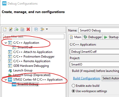

I have a project that I started and am currently debugging with STM32CubeIDE. Seemingly overnight it decided to start showing me that same error message whenever I clicked on the debug icon. For me the problem ended up being that I somehow had selected to debug as "C/C++ application" instead of "STM32 C/C++ Application". I couldn't quite figure out how to set up the "C/C++ application" configurations to work, but I'm back up and running again with the STM32 application that I had set up previously. That one seems to be ready to go with minimal to no changes on initial setup.

Error caused by ProjectName.launch file not created.
Make sure the project name is selected -> "debug as" -> STM32 Cortex-M C/C++ Application.

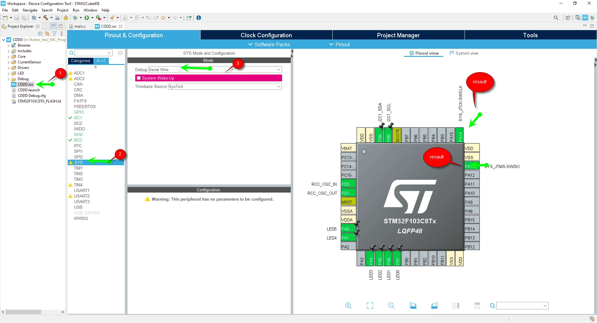

Hi. Please
1) check your programming type
2) regenerate cube MX in your project.
3) CTRL+S (for save)
4) start to test programming and debug
