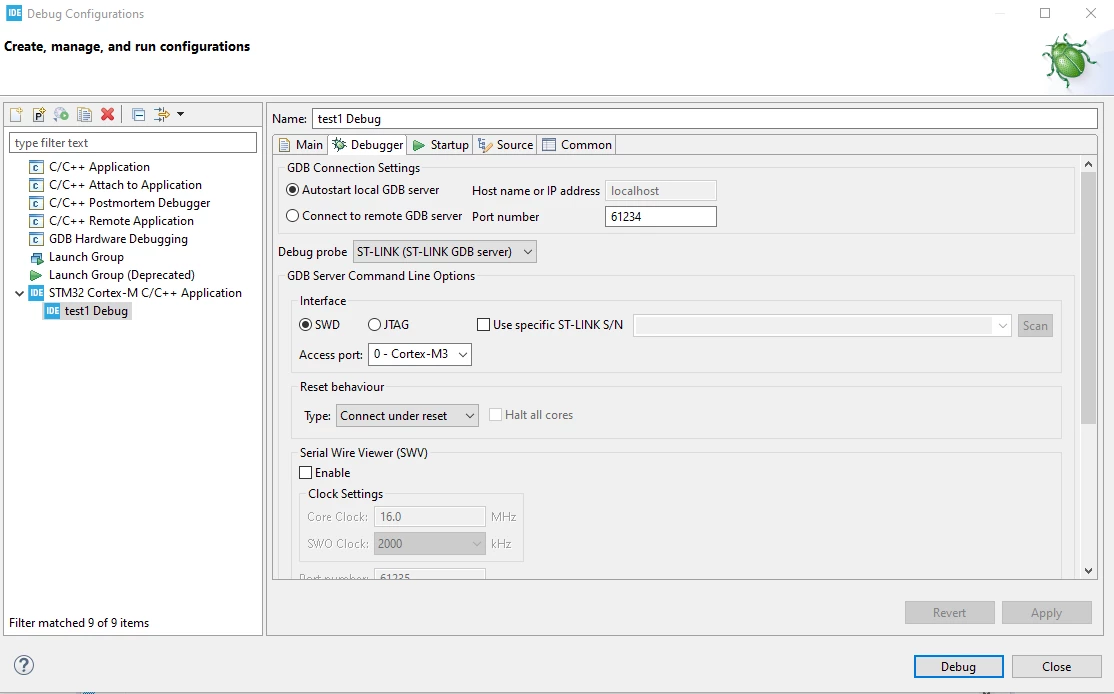

I found the problem.
If you run the debug, you should check your debug configuration and use "STM32 Cortex-M C/C++ Application".

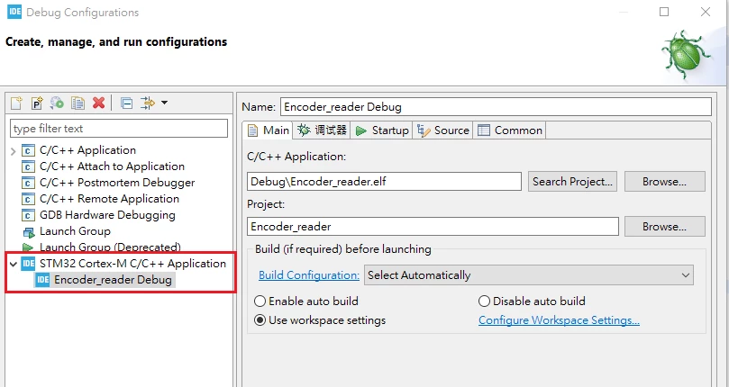

Two things to check if you experience this problem:
  1. Are you using the right debug configuraiton type?
    1. Go to Run -> Debug configurations... The debug config (referred to as launch configuration in Eclipse world) must be of type "STM32 C/C++ Application". You should not have any configurations under the other nodes in the left-side panel. Well, maybe you have downloaded a PC toolchain to also make some x86/PC application in that case those would be launched with "C/C++ Application" configurations...

I also ran into this issue after a couple days of everything working. This worked for me:
Select Project/Properties and select Run/Debug Settings. Delete all of the Launch configurations listed. Click Apply and Close.
The next time you try and debug, the Debug As dialog will pop up, select the STM32 Cortex-M C/C++ Application. That should fix it.
