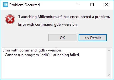

0690X00000AriqlQAB.pngI am having the same problem on a project I converted from Atollic TrueStudio 9.1.0. It compiles just fine, but I can't debug now.
Where exactly is the option to log to a file? I can't find what you mean.
I did find this error log about the problem:
!ENTRY org.eclipse.cdt.dsf.gdb 4 5012 2019-11-05 16:04:49.906
!MESSAGE Error with command: gdb --version
!STACK 0
java.io.IOException: Cannot run program "gdb": Launching failed

Looks like you don't have it pointed to the correct exe. In the "Debugger" tab give full path of the gdb.exe(Windows machine) of the cross compiler that you might have installed as the "GDB command".
For me it is "C:\Program Files (x86)\GNU Tools Arm Embedded\7 2018-q2-update\bin\arm-none-eabi-gdb.exe"

You are correct, but I think the underlying issue is that Atollic installed gdb.exe and STM32CubeIDE does not. At least not for me. I have searched the install path and I can't find it. I assumed it would install everything that was needed just like Atollic did.

Actually it did not fix my problem. I pointed to gdb.exe from a previous installation and it gave me different errors. The gdb.exe is supposed to be installed with the IDE and for some reason on my machine it is not getting installed.

I installed STM32CubeIDE and also get the
message. Perhaps an explanation of how to install gdb and set up STM32CubeIDE to use it would be usefull. Documentation is usefull.

UM2563 STM32CubeIDE installation guide ?
All external tools are installed during STM32CubeIde install in the plugins folder. On a recent Win10 install, compiler+debugger are in C:\ST\STM32CubeIDE_1.1.0\STM32CubeIDE\plugins\com.st.stm32cube.ide.mcu.externaltools.gnu-tools-for-stm32.7-2018-q2-update.win32_1.0.0.201904181610.
Avoid complications in the install path: no spaces, no long path, all ASCII.

Hello - I was going to come back here and update. I went to Debug Configurations, and changes Debugger from gdb to arm-none-eabi-gdb, enabled Serial Wirer Viewer. That got me running. Just now commented out the " __HAL_AFIO_REMAP_SWJ_DISABLE()" call. I am running what I believe to be commonly known as the Blue Pill STM32F103C8 board. I am running my code now ..... thank you for making STM32CubeIDE available to hobbyists such as myself !
