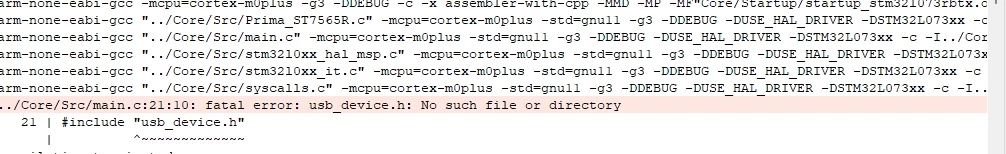

STM32cubeIDE cannot find usb_device.h file even after re-installing and including path in settings
Greetings,
I am developing code for USB device and I just started interfacing USB in STM32cubeIDE. After configuring settings in .IOC file, I generated the code without any error.
However, while building the program it shows below mentioned error. after some quick server I found this post. I tried including path in properties > settings. Also, I just downloaded latest version and did not used any old versions before. I also re-installed the software but it does not work at all.
Even after creating whole new project. It does not work. My repository settings are already default and did not changed at all.
Please help me. I cannot think of anything and tried whatever I found or suggest any other suggest to make it work. maybe other compilers or something else.
Thank you so much for your efforts in advance

Hello @Jeet ,
First let me thank you for posting and welcome to the ST Community.
Further to your comment, I download your ioc and load it on STM32CubeMX 6.11.0 and build it on STM32CubeIDE 1.15.0.
The Firmware Package : STM32Cube FW_L0 V1.12.2.
The compilation error was not reproduced by my side.
Thanks.
Mahmoud.
May 22, 2024
I just installed 1.15.1 and lost my abitlity to compile any USB code
