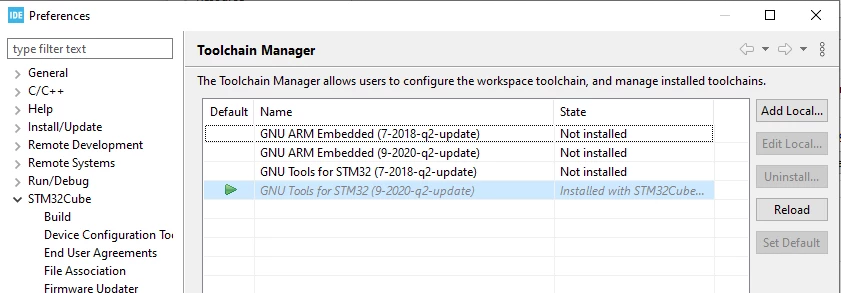

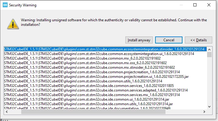

Updated from v 1.5.1 today, on WIn10, from the IDE itself.
The update worked well, but here are some issues - in order of occurrence.
1 The update components are still unsigned :( At least, signature isn't recognized.
2 After update, the version in the Windows Registry still is 1.5.1., and the desktop shortcut still says 1.5.1.
Will affect these who detects the version using the registry.
3 After update, the ARM toolchain 9-2020-q2 is installed, but the previous 7-2018-q2 remains installed too.
This IMHO is good because users may want to keep the previous toolchain for existing projects.
Swapping the toolchain on existing project is the proverbial cheese-moving.
This is exactly what happened to my projects: toolchain changed to the new one.
And it won't let me select the 7-2018 although it sits on the disk.
The Toolchain manager thinks it is NOT installed and shows now this:
0693W000007Ze70QAC.png4 The change of project toolchain clobbered all my debug configurations.

Julien D
March 1, 2021
Hi Pavel.A,
1/ True, unfortunately. Things are moving, actually not as fast as we would like. Anyway this is not blocking at all.
2/ This is expected, uninstall.exe from install path is linked to the original version. If product update propagate the version to the registry then native uninstallation might be broken.
3-4/ Do you have any errors when trying to install gcc7 ? If so past them here, plus possibly your workspace log file (workspace/.metadata/.log).
Here is how it is supposed to work: select it and press Install button, let installation proceed into the background (see it in status bar at the bottom-right corner), restart STM32CubeIDE when prompted, and it should be there.
Then you can either set this version at STM32CubeIDE global level from the Toolchain Manager, or per project (see Project Properties > C/C++ Build > Settings > Tools Settings tab > MCU Toolchain).
5/ This is actually well known from upstream component (Eclipse/CDT), caused by the migration to Java11.
It should be solved when upgrading the Eclipse platform later this year.
Kind regards
Pavel A.
March 2, 2021
@Julien D_OEHAUDT​ I made the package manager to see the 7-2018 package by installing as "Local" (pointed to existing directory under plugins).
Sorry don't have time for toolkit management. Debugging makefile projects has higher priority for me because our customers need it. [see this thread]
All other issues are minor.
