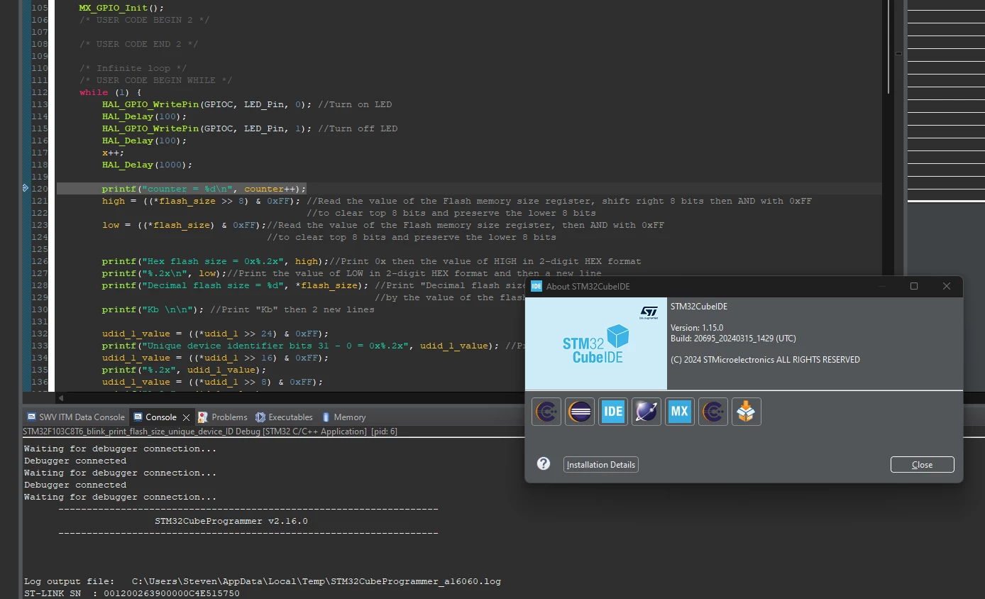

SBenn.2
March 24, 2024
Could the problem be some other part of your system, I have no problem connecting the debugger to the target and single stepping and running to breakpoints?
