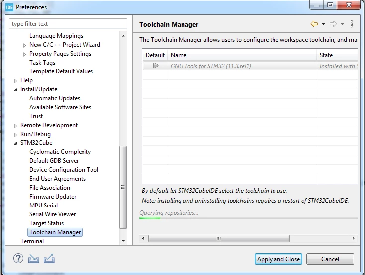

Senior
Apr 3, 2024 2:27 PM UTC
As posted countless times: this is because cube 1.15 upgrades the GCC tools from v11 to v12.
You can revert the tools back to v11 here
Or uninstall cube and install 1.14.1 which is still on the ST website (for not much longer so grab it quick!)

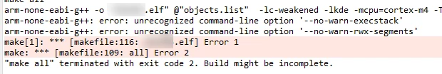

PHolt.1
Senior
Jul 26, 2024 9:00 AM UTC
The linker options supplied further back in this thread are invalid for GCC.
I have Cube IDE v 1.16.0.
Brian TIDAL
Jul 26, 2024 11:41 AM UTC
make sure to use -Wl,--no-warn-rwx-segment in order to pass the --no-warn-rwx-segment option to the linker. See option for linking in the GCC documentation.
Rgds
BT
PHolt.1
Senior
Jul 26, 2024 2:21 PM UTC
Thank you, but I went back to 1.14.1 because I could not get 1.16.0 to work with any debugger I have. I might revisit this with 1.16.1 :grinning_face:
