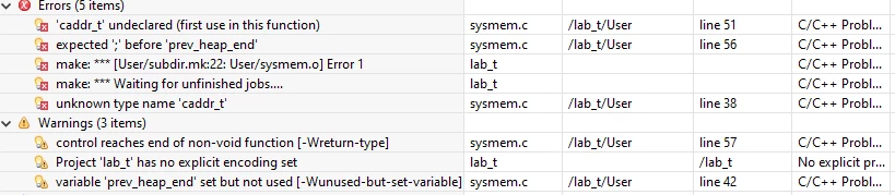

while using 1.13.1 version of STM32CubeIDE on a  STM32H735G-DK board I encountered 5 errors which did not happen while using previous versions.
The errors are as follows:
Can anyone help with what might cause these errors and how can they be fixed?

    Hello
    Its most likely this problem
    https://community.st.com/t5/stm32cubeide-mcu/stm32cubeide-1-13-0-released/m-p/573461
    Br J.T

    What previous CubeIDE version were you using?
    Did you re-generate this code from IDE v1.13.1, or just attempt to re-build/compile code generated from a previous version?  In other words, did the contents of system.c change from the old IDE version to the new?
    It may be that 1.13.1 uses a newer GCC version than whatever IDE version you used before.  And that newer GCC version may enable different/more warnings by default.  Or a missing include file (sys/types.h)?

    Hello @fzbarati ,
    Thank you for sharing this issue.
    Could you , please, provide the version of the installed toolchain. It is found under properties-> C/C++ build-> Settings -> MCU toolchain -> Toolchain manager.
