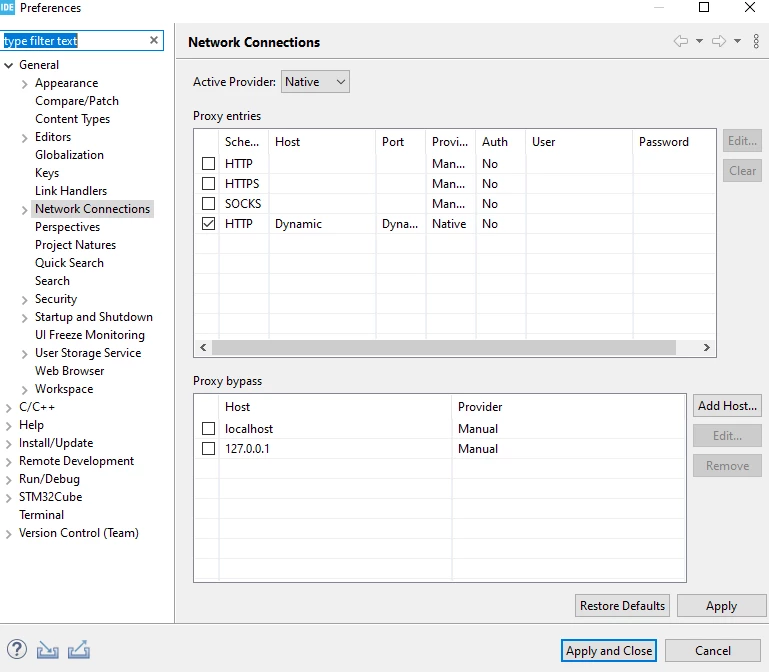

    Hello @AmaniAlzahrani ,
    If your machine is connected to the internet via a proxy, you need to set the correct connection parameters
    [Host ; Port] to establish the link to the server.
    In this case, you should set the Active Provider to manual, otherwise you can work with the Direct option.
    Thanks.

    I am following these steps in the provided post
    There is a step that says: "Update the proxy entries for HTTP and HTTPS with specific HOST, Port, User, and Password using the [Edit...] button"
    I do not understand what the HOST, Port, User, and Password should be.

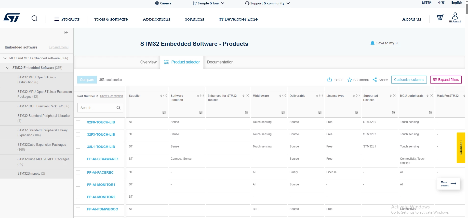

    Also, at a later step, when I opened the provided website to download the software package, I didn't know which to download.
    This is what is shown to me:
    I appreciate all your help and support
    I advise you to set the Active Provider: Direct under:
    Window->Preferences->Network Connection
    Then check the Connection under:
    Window->Preferences->Firmware Updater->Check Connection
    Then log to your ST Account
    After the IOC configuration, click on Generate Code [CTRL¨+S] and the firmware will be successfully downloaded.
