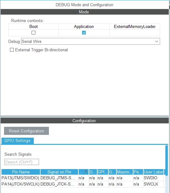

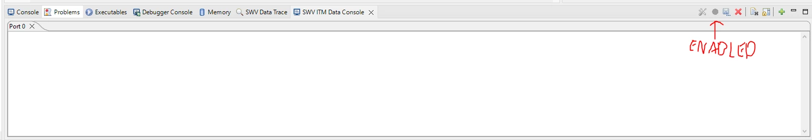

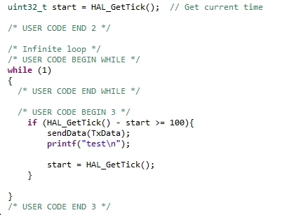

I have a STM32H7S78-DK which is equipped with a STM32H7S7L8H6H MCU. I'm trying to get the Serial Wire Viewer (SWV) to work, but so far without succes. I have also tried it with Core Clock frequency set to 600MHz in the debugger SWV settings.
I'm new to the toolchain so I think it is likely I'm just overseeing something. Any help would be appreciated!
My current settings:

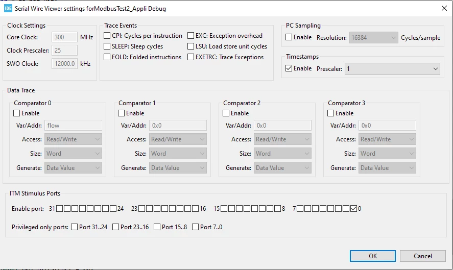

Hello @Haveyoutriedturningitoffandon ,
The core clock is important, you should set it correctly in the debugger SWV settings at 600MHz.

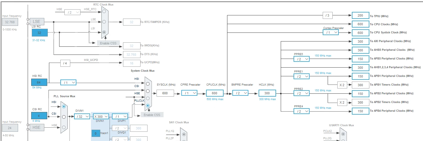

Having gone through the same trouble with an H7S3L8 board, have you tried to divide the core clock by 3 ?
(Our board has a 600Mhz core clock by default, setting it to 200Mhz worked)
The information should be available in the RCC charter of the reference manual.
(Slower devices use the core clock, while the H7 is core / 3)
