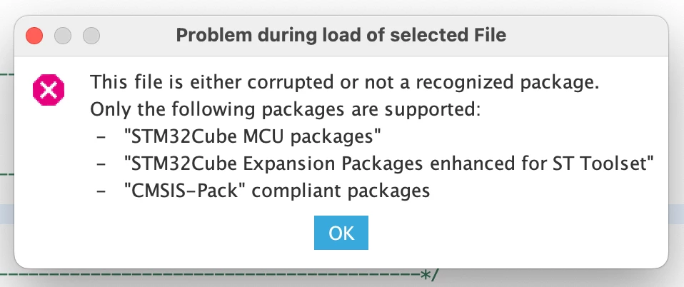

I get this error trying to install the X-CUBE-SPN1 extension for X-NUCLEO-IHM01A1 in STM32CubeIDE.
I have downloaded the latest version of the X-CUBE-SPN1 extension and version 1.13 and 1.15.1 of the IDE.
I get this error:
Anyone has faced this problem?
Thanks in advance.

Not all X-CUBE packages are yet integrated in CubeMX or CubeIDE, but must be integrated manually. If one of the examples from the projects folder is sufficient for you, you can also unpack the X-CUBE in a path with a short name (e.g. C:\ST for Windows) and import the project directly from there.
The problem has already been discussed with a similar, non-integrated package.
Hope that helps?

I have tried installing other packages from local and apparently same issue occurs. Any idea of what could be the problem?

Thank you Peter. I will try installing it manually. There might be better documentation or installation instructions on this package.
