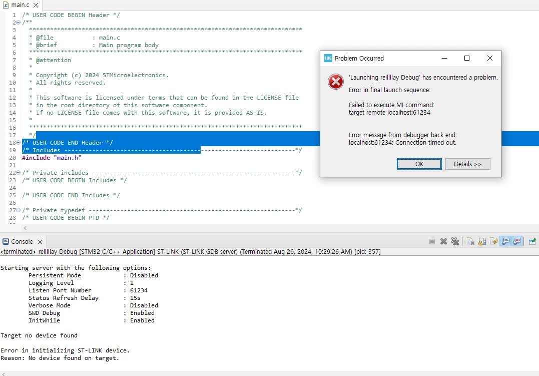

NO STM 32 Target Found, Target No Device Found (Nucleo-F446RE)
what should i do..?

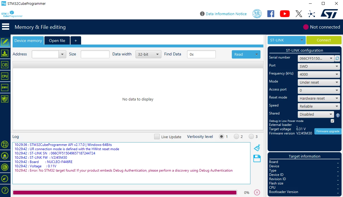

TDKBest answer
August 26, 2024
> Target voltage: 0.31 V
This is a power issue. No change of a chip working without a proper power supply. Ensure the power jumper is set correctly. Perhaps a part on the board got damage in the course of debugging. It sees the ST-Link chip, so the board is probably okay. Consider looking at the schematic to track down the power issue.
