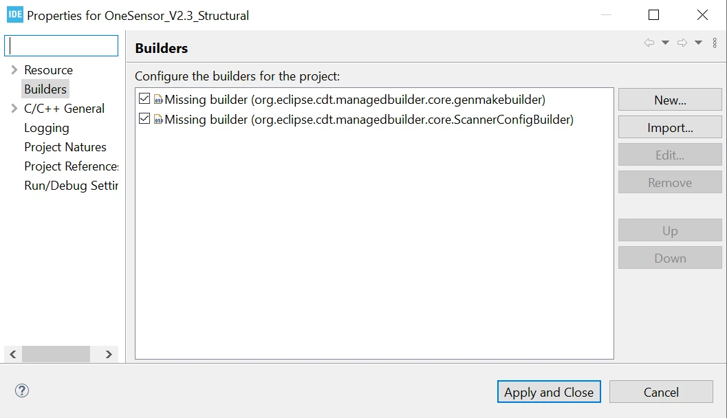

Missing project builder/toolchain configurations in CubeIDE
I am trying to build my first STM32H7 project. I used CubeIDE (the MX module?) that seemingly works fine and generates the project code and source files using the default configurations. However, after opening the newly generated project, no C/C++ toolchain is set and there is no builder available in the project properties window (please see attached). This problem doesn't exist if I load an example project into CubeIDE, as the CDT builder is available there and everything compiles just fine. What have I been missing?
CubeIDE is the latest 1.5.1 version. I tried re-installing and encountered the same problem in both Windows 10 and Linux OS.

I have a similar problem after updating to 1.5.1 version.
