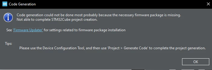

I downloaded version 1.15.1 of the STM32 IDE, but when I start a new project and select the STM32F103C8T6 as the MCU, the first image appears. However, when I try to update the firmware, it asks for a login, and the second image appears. I have searched in several places and realized that this is an error that can occur since versions 1.12/1.13. I have tried changing the network connections to active provider (native, manual, and direct), but it doesn't work. (I'm not sure how the manual one works, but I also saw that it's not good to keep using manual mode). Does anyone have any suggestions? The same problem occurs in STM32MX, and I have also tried changing the internet connection.

    This is an issue some CubeMx/CubeIDE users are facing since yesterday and the issue was escalated internally to be fixed asap. Dedicated teams are working on it.

    Been down for two days now... I can log in through the web site, but the CubeIDE will not log in. It hangs and says the network is down. I have no proxy, VPN, or firewall blocks. I am working on a new design and can't generate code from the ioc file if not logged in. I would strongly recommend making login optional for critical tasks and just keep retrying in the background.
    NOTE: I had another system that was logging in on its own at startup just fine. I stupily logged out to see if the problem was machine specific and now that system won't log in either.
    Graduate II
    May 16, 2024
    workaround: install CubeIDE 1.12.1
    It has no login functionnality and use latest packages.

    Here is a video showing the problem 7zipped, I am stuck because of this issue and I will downgrade version to 1.14.1, 1.12.1 or something like this to unblock myself...
    May 16, 2024
    Reverting to v1.12.1 and setting MxCube.Version=6.8.1 unblocked the code generation feature.
    This issue needs to be solved before upgrading a newer version. We tried 1.13.2, 1.14.1 and 1.15.1 without being able to do code generation, it seems to be Windows related as a colleague successfully generate code using 1.14.1 under Linux.

    Dear all,
    Seems the issue has been solved please check from your side.

    I am able to login with version 1.15.1 of IDE. Thanks for your efforts.
