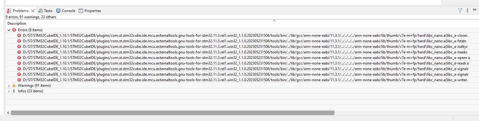

Link errors after update for MCU Tools libc_nano
Since updating the Cube IDE last week it's listing  9 link errors on compile related to the MCU tools, nano lib, but if I just compile it again the errors disappear!
Before the update this didn't occur.
If anyone else has this or knows a fix, please let me know.

    Hello @Robmar ,
    Could you, please, check the includes by right-clicking on the properties of the project, selecting Properties, then navigating to C/C++ Build > Settings > Tool Settings > MCU GCC Compiler > Includes. Also, check the toolchain version 11.3.rel1.
    Hope this helps !

    Sorry Rim, but your message is really not helpful to say the least.
    Our project has been compiling perfectly since 2015 in debug and release, only after the 1.12 Cube IDE update did we start getting this compiles/doesn't compile situation.
    We are on the same toolchain 11.3rel1 that you mention.
    Now after today's update 1.13 we´re getting a permanent 17 errors, defines that previously linked, no longer link.
    I am updating the toolchain and will retest after rebooting the IDE, but I doubt this will solve the issue.
    I really think STM have lost control of the IDE source code.

    Hi Rim, so I just finished and it wasn't anything to do with includes, simply by reloading the same toolchain, making no changes, then rebooting the IDE twice, it got back to failing the compile the first time with the same 9 errors, then if compiled directly again, magically with 0 errors!  STM IDE is generally a mess IMHO, and needs a serious reworking probably with a new manager who can get the team to locate and fix all these quirks.
    But I'm guessing you're going to tell me that's not your responsibility.
    Some of the STM MCU education content on the web is good, but then fails when trying to implement due to a lack of maintenance.
    For example, the STM educational content for H743 says that the third-party code supports USB 2.0, but then the USB code in new projects looks like USB 1.0 with a fixed 22100 sample rate.
    Why isn't the USB 2.0 driver installed after selecting USB devices in the MX, and where are the code examples to test USB 2.0a on the H743?
    I've already posted a support case for this USB issue last week, and so far no response apart from it's been escalated.

    Hello @Robmar ,
    The issue is not reproduced with a simple STM32CubeIDE project after update from CubeIDE 1.10.0 to 1.13.1.
    But, when I tried with an STM32CubeIDE example for X-CUBE-SBSFU package I have the same behavior that you faced and there are errors related to the link with libc_nano library after update.
    To further analyze the issue, could you, please, provide the content of the console view.
    Also, it would be helpful to share more information about the project such as, if you have used a specific configuration or a software package.

    Hello Robmar.
    The problem that is causing the failed build was fixed in CDT (https://github.com/eclipse-cdt/cdt/commit/1b2472faff2028f0323ad5c5eb85565f81b89053) last Friday and should be available in the Eclipse SimRel 2023-09.
    The fix will however only be available in STM32CubeIDE after this version has been integrated.
    We'll do our best to provide an update as soon as possible according to our roadmap.

    Hello @Robmar
    I apologize for the late response.
    The good news are that this issue will be fixed in the next release which will be published in the near future.
    KR,
    Semer.

    Had the same issue.
    What helps is this
    https://community.st.com/t5/stm32cubeide-mcus/stm32cubeide-1-13-0-problem/td-p/573904
    The problem was the update from CDT toolchain 10.3 to 11.3
