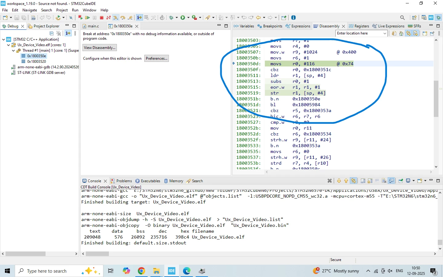

  • I right-click on the Ux_Device_Video→ Debug As → it flashes successfully, but the program never reaches  main(). (Normally in every program the debugger points to first line in main).
  • When I press Run, the debugger only executes a few assembly lines like below and stays there:

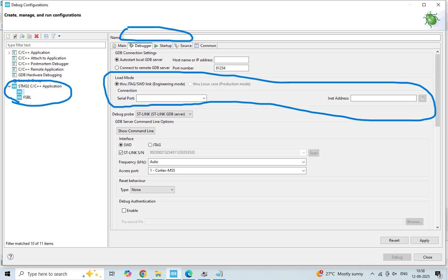

What I observed in Debug Configurations (screenshot attached):
  • For all other example projects, the Debugger tab looks normal , and in this project even FSBL  flashing good and stops at main and behaves as expected.
  • But for Ux_Device_Video, I see an additional “Load Mode” section (highlighted in my screenshot). Other projects don’t have this.
  • Also, under STM32 C/C++ Application, I normally see two entries (e.g. FSBL and the application). But here I only see FSBL, not Ux_Device_Video.
  • The top “Name” field in Debug Config is also empty, unlike other projects.
  • I tried to modify the debug configuration manually to match working examples, but this project does not accept the changes.

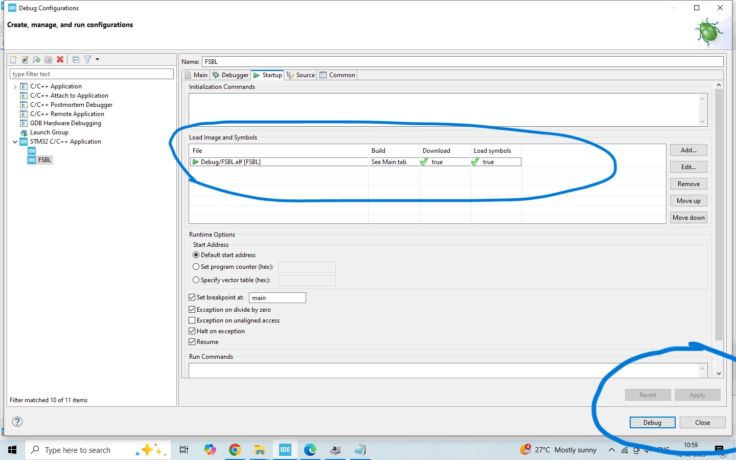

bellow image is FSBL project configuration , i tried to add the same for the ux_device_video  but there is no options( Apply or debug ) are enabled for  change .

However, I did some further testing:
  • When I import the same project in STM32CubeIDE v1.18.1, it works fine and the code enters main() as expected.
  • But with STM32CubeIDE v1.19.0, the issue appears.
  • I have tested on four different PCs with v1.19.0, and the behavior is the same on all of them.
So it seems to be related specifically to the new IDE version (1.19.0).
Could you please check this from your side and let me know the insights or if it is a known issue in CubeIDE 1.19.0?
