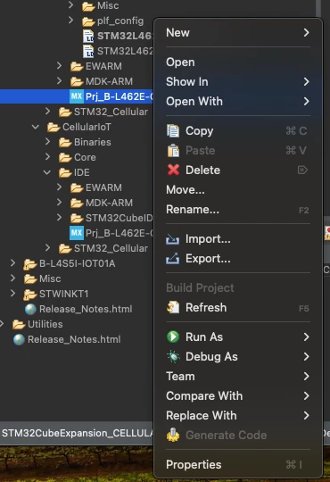

I wanted to change the .ioc file and configure the pins for my sensor but i can not open it (SS attached). Any suggestions on how to fix it? I have tried renaming the Prj_B_L462E_CELL01.ioc file to 'STM32CubeExpansion_CELLULAR_V6.0.0.ioc' but that also shows the same error.

The error message indicates that the STM32CubeExpansion_CELLULAR_V6.0.0.ioc file is set as the active .ioc file for the project, but you are trying to open Prj_B-L462E-CELL01.ioc
In STM32CubeIDE, right-click on the Prj_B-L462E-CELL01.ioc file in the Project Explorer and select "Set as Active .ioc File".

I followed your instructions but I couldn't find the "Set as Active .ioc File". option.

Hi @Sarra.S,
The thread wasn't that helpful. I still couldn't figure out how to set the .ioc file as active. However, I could open it with the option open from an existing .ioc file.
