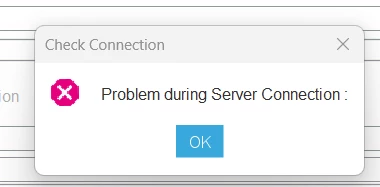

Im unable to connect to internet in IDE and MX. Check below image in IDE

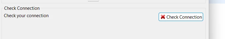

Below seen in MX

September 25, 2024
Hello @GauravK ,
Are you running the tools behind a proxy server ?
It may be Firewall or proxy issues, in this case make sure that the necessary ports and protocols are allowed and that the proxy settings are configured correctly.
Check the Network proxy settings and recommendation in the following User manual:
GauravKAuthor
Senior
September 25, 2024
No proxy server. But firewalls can be there...
But I didnt face this issue previously... this week only observed
I tried changing network connections settings... but same issue faced
Semer CHERNI
September 26, 2024
Hello @GauravK
I will suggest you check this article describing how to set the network connection for STM32CubeIDE and STM32CubeMX. link
BR,
Semer.
GauravKAuthor
Senior
September 26, 2024
Im still facing issue. I tried in IDE and MX but same, problem during server connection. I have tried to install new softwares of IDE and MX also but same issue.
I dont have proxy internet. I have tried 1. No proxy and 2. System proxy options.
What to do?

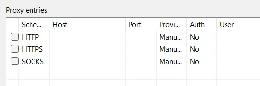

September 27, 2024
I dont see Native option in proxy entry:
