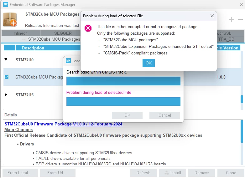

STM32CubeIDE 1.15.1 login error, although Check Connection shows "green" in the "Firmware Updater". Because of the Login error I cannot Install "STM32CubeU0 Firmware Package V1.0.0 / 12-February-2024".

  1. Use System Proxy Parameters for STM32CubeMX:
     I actually get "green" Check Connection with the default Settings in Direct, Manual & Native, Network Connection Settings, and also Refreshed the SW! If the "Connection Check" is working properly, this should be an indication of that there is a connection, but the error is somewhere else.
  2. Install packages while offline:
    There is a problem during load "From Local", as shown in the snipped picture below:

I was also able to find and download "en.stm32cubeu0-v1-0-0.zip" from
https://www.st.com/en/embedded-software/stm32cubeu0.html#tools-software,
and tried to install it from my "Downloads" directory. The bad result was in the snippet picture I posted abowe.
(I was even able to unpack the ZIP.)

Hello Semer,
thanks for your assistance!
I could fetch and install STM32CubeMX, and got the same errors when trying local package installation and login. The log file is attached below.

Hello Semer,
Thanks a lot for your help, :smiling_face_with_smiling_eyes:
the issue on your server seems to have fixed my errors, and I can login and have installed the
"STM32CubeU0 Firmware Package V1.0.0 / 12-February-2024"!
How can I tell the community that you solved the bug?
