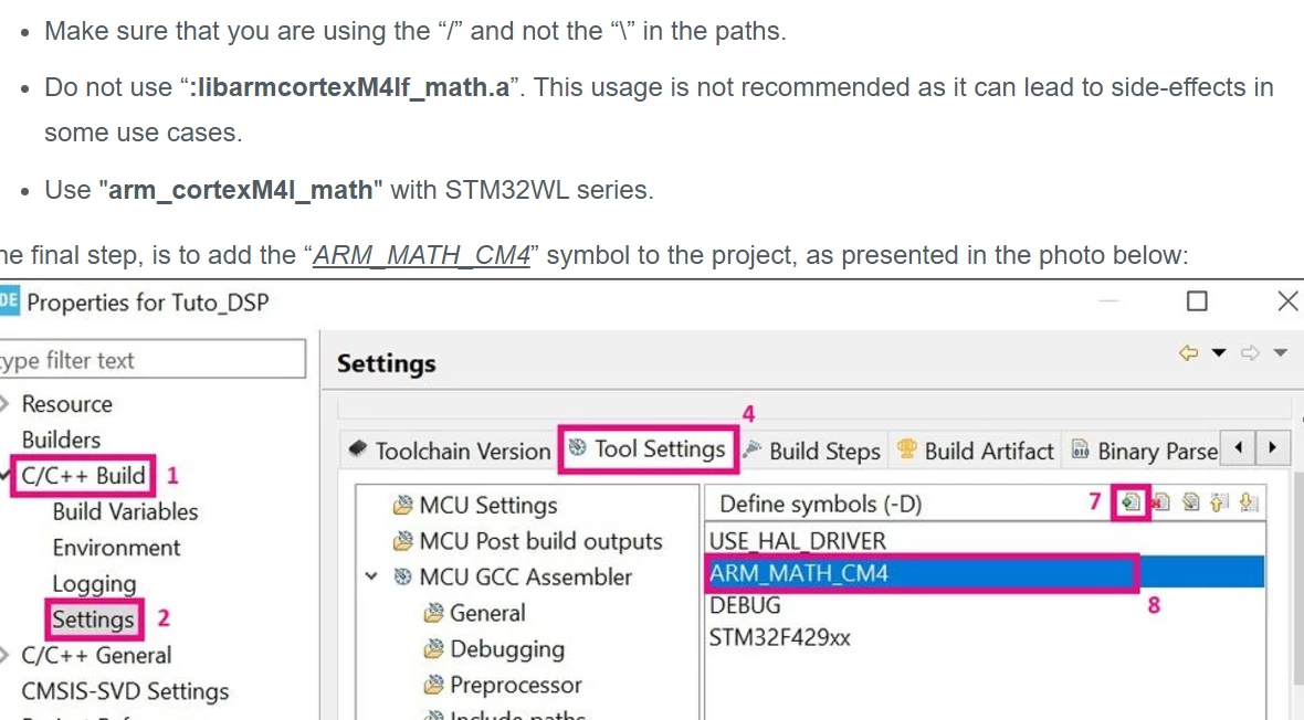

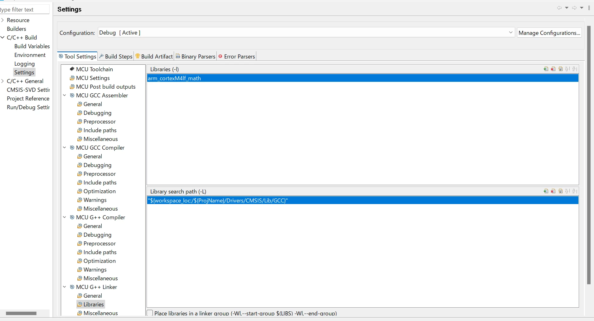

Nov 28, 2024 1:21 PM UTC
Since I am using stm32h742 this time, do I need to change M4 to M7 for these two below?
Best regards.
KDJEM.1

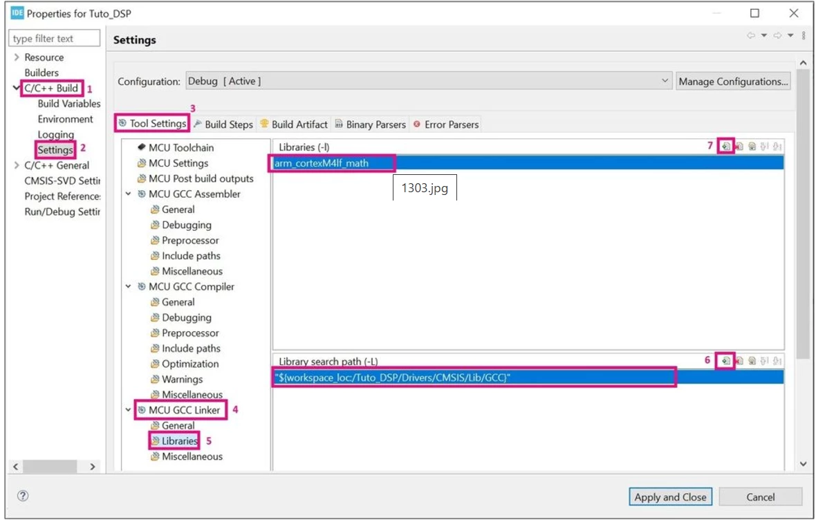

Nov 28, 2024 1:34 PM UTC
Hello @baby_chicken,
Yes, the libraries depend on the core you are using.
So, from Project menu or File menu, go to Properties > C/C++ Build > Settings > Tool Settings > MCU CGC Linker > Libraries > Libraries (-l) > Add and insert the following libraries: "arm_cortexM7l_math," "arm_cortexM7lfdp_math" and "arm_cortexM7lfsp_math".
Please use ARM_MATH_CM7 instead of ARM_MATH_CM4.
I think this post: STM32H723 CMSIS DSP can help you.
Thank you.
Kaouthar

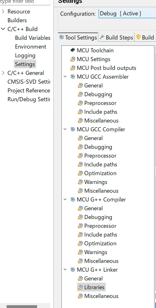

Nov 28, 2024 2:30 PM UTC
There is no MCU CGC Linker, but MCU G++ Linker is available.
Best regards.

Nov 28, 2024 2:46 PM UTC
Are you using C++?
If you use C++, could you use "MCU G++ Compiler" for including paths and preprocessor and "MCU G++ Linker" for including libraries.

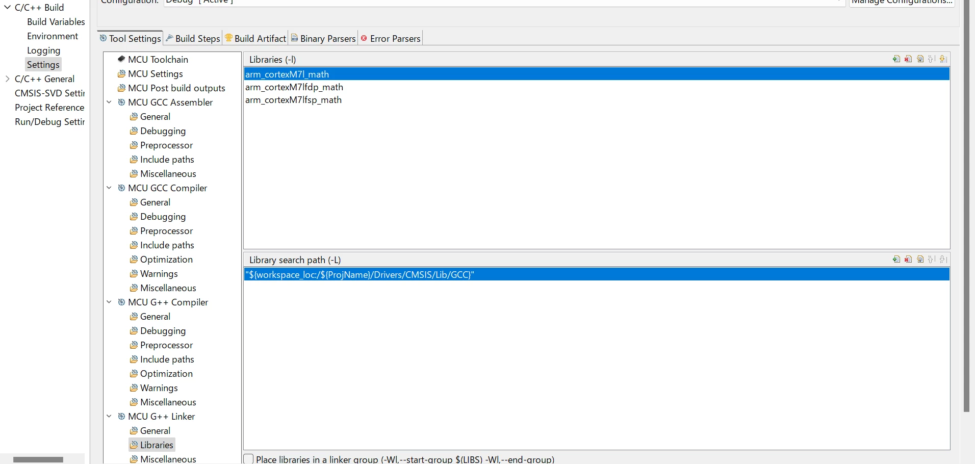

Nov 29, 2024 9:18 AM UTC
MCU G++ Linker> Libraries > Libraries (-l) has “arm_cortexM7l_math,” “arm_cortexM7lfdp_math” “arm_cortexM7lfsp_math”. Add these.
What should I add to MCU G++ Compiler> Include paths > Include paths(-l)?
Am I correct in this perception?
Best regards.
KDJEM.1

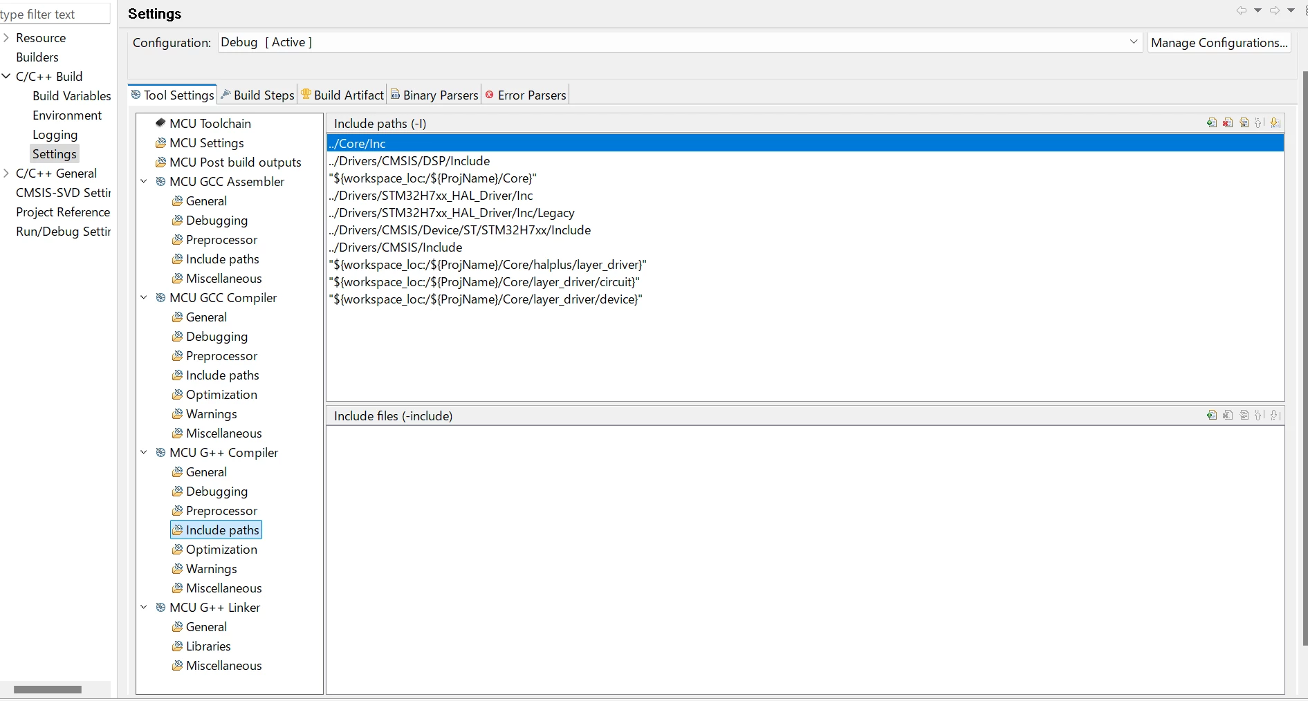

Nov 29, 2024 10:25 AM UTC
Hello @baby_chicken
-->Add ../Drivers/CMSIS/DSP/Include path
Thank you.
Kaouthar

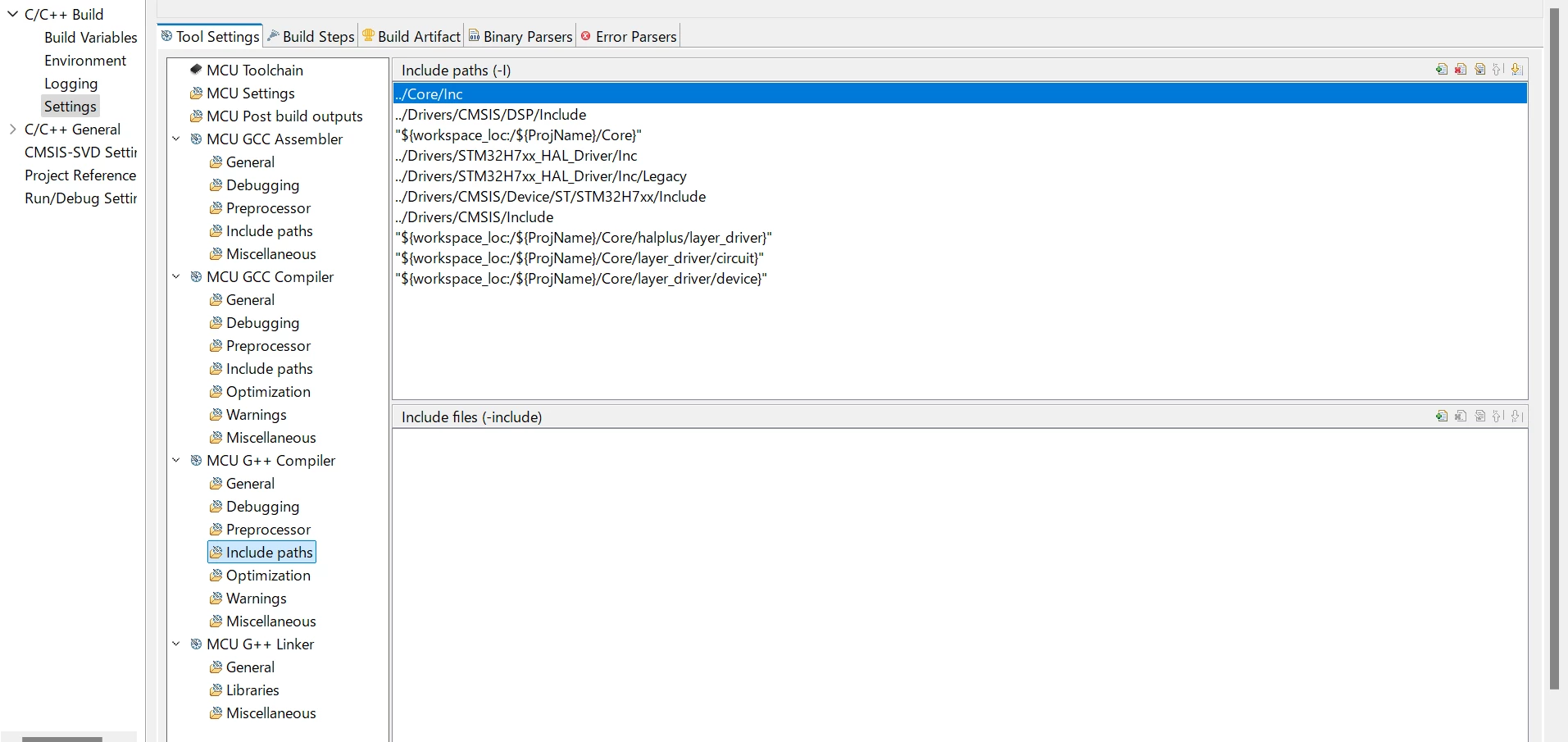

Nov 29, 2024 10:45 AM UTC
Is this correct?
The build went through.
Best regards.
KDJEM.1
Nov 29, 2024 10:52 AM UTC
Yes, it is correct.
