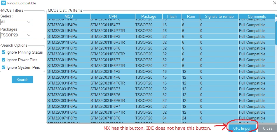

How to switch MCU by CubeIDE?
When I used CubeMX, MCU could be switched to select
[Pinout]→[List pinout compatible MCUs]→[OK, Import]
However, in case of CubeIDE, the [OK, Import] button is not appeared.
Is the "switch MCU function" deleted?
Thanks your help,

    https://community.st.com/t5/stm32-mcus/how-to-switch-from-one-stm32-to-another-using-stm32cubemx/ta-p/49884
    https://community.st.com/t5/stm32-mcus/mcu1-to-mcu2-migration-option-within-stm32cubeide/ta-p/49650
