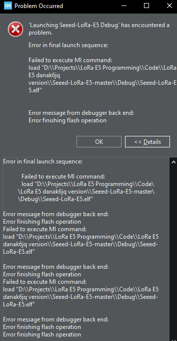

How to solve Error Finishing Flash Operation in STM32CubeIDE?
Recurring Error Message in STM32CubeIDE When Running or Debugging a Project. It shows-
'Launching pain Debug' Has encountered a problem.
Error in final launch sequence:
Failed to execute MI command: load
C:\\Users\\USER\\STM32CubelDE\\workspace_1.12.1\\pain\\ Debug\\pain.elf
Error message from debugger back end:
Error finishing flash operation.
and also it showing
"Error in final launch sequence:
load C:\\Users\\USER\\STM32CubeIDE\\workspace_1.12.1\\try\\Debug\\try.elf
Error finishing flash operation"
How to solve this problem? We are using STM32 NUCLEO-F446RE Board

Hi, I've got the same issue. Here's the error log that appears in the failure message:
load C:\\TouchGFXProjects\\MyApplication\\STM32CubeIDE\\Debug\\STM32U5A9J-DK.elf
Here are the messages from the console:
STMicroelectronics ST-LINK GDB server. Version 7.4.0
Copyright (c) 2023, STMicroelectronics. All rights reserved.
Starting server with the following options:
Persistent Mode : Disabled
Logging Level : 1
Listen Port Number : 61234
Status Refresh Delay : 15s
Verbose Mode : Disabled
SWD Debug : Enabled
InitWhile : Enabled
Waiting for debugger connection...
Debugger connected
Debugger connected
STM32CubeProgrammer v2.14.0
Warning: The external loader file does not exist:
MX25LM51245G_STM32U599J-DK.stldr
Encountered Error when opening C:\ST\STM32CubeIDE_1.13.1\STM32CubeIDE\plugins\com.st.stm32cube.ide.mcu.externaltools.cubeprogrammer.win32_2.1.0.202305091550\tools\bin\STM32_Programmer_CLI.exe
Error in STM32CubeProgrammer
Shutting down...
Exit.
