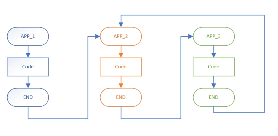

I am a newbie in embedded programming. My idea is to build 3 applications with 3 separate project file. These 3 applications will work together in 1 CPU as shown in the image below:
To jump from App to another APP, I do the same way bootloader jumps to application:

Jump from one application to another was successful. But the obvious problem here is that data segment initializers copy from flash to SRAM of APP_2 and APP_3 will be performed repeatedly in a loop. I thought of a few ideas like: skipping the copy instructions in the startup code from the 2nd loop onwards, but I'm stuck. I don't find any commands related to _sdata, _sidata... or bss in the startup file generated by STM32CubeMX.  Is there some hidden code associated with the current startup file? Can I create a custom startup file to replace the current startup file?

Yes, APP_1 only runs once, then APP_2 and APP_3 will form an infinite loop. In each main function of each APP there is no while (1) loop. All apps are in only 1 CPU.
But APP_2 and APP_3 run in turns. You must allocate separate data areas for APP_2 and APP_3 else they will overwrite data of the other app. If their summary data size does not fit in the physical RAM, you'll need to save the data of one app before jumping to another.

Yes, I have allocated separate memory areas for each application.
