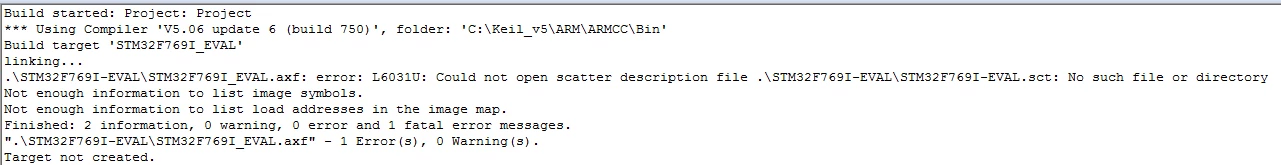

I find some others subject about it but I failed to create the stldr file :
I tried to use the N25Q512A_STM32F769I-EVAL example for external loader with Keil to generate an axf file to change it in stldr file (UM2237) but I have an error when I build it :
My project is on STM32CubeIDE and I find where the external loader files are (Debug configuration --> Debugger --> External loader) but I don't know how easily create the stldr file for my custom board.

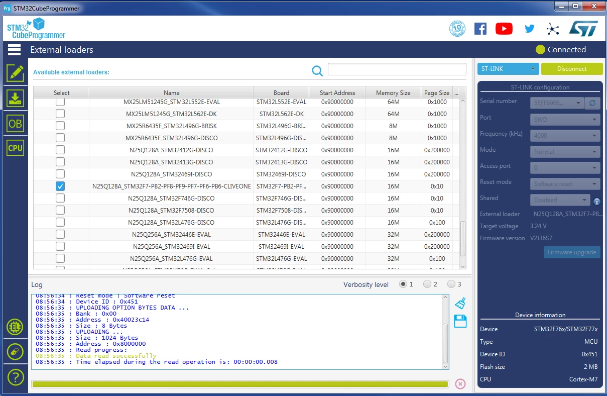

Some updates,
I generate a stldr file by using the method described here : https://www.youtube.com/watch?v=XqCq0xtQmbI&list=PLnMKNibPkDnHIrq5BICcFhLsmJFI_ytvE&index=5
I used it in STM32CubeProgrammer and I can read and right my external memory flash.

Tesla DeLorean
Guru
September 15, 2020
The scatter file can be found in the example projects
STM32CubeProgrammer_v2.4.0\bin\ExternalLoader\N25Q256A_STM32L476G-EVAL\Project\MDK-ARM\loader.sct

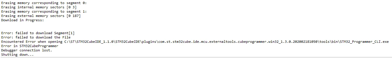

TGate.1
TGate.1Author
September 15, 2020
Hi Clive,
Thank you for your answer,
I generated the stldr file and I test my loader as described here and it worked : https://www.youtube.com/watch?v=XqCq0xtQmbI&list=PLnMKNibPkDnHIrq5BICcFhLsmJFI_ytvE&index=5
But I have an other project on STM32CubeIDE with the same STM32 and TouchGFX. I would like use this loader to program the external memory flash with images but I have an error with STM32CubeProgrammer :
The programmation of the external memory doesn't worked when I use STM32CubeIDE

Tesla DeLorean
Guru
September 16, 2020
Would check if file is there, if execution is blocked by AV, or missing .DLL that the STM32_Programmer_CLI depends upon
Not clear if the error here is with spawning the file, or something on the command line, and the application is returning an error code.
If it is specifying the external loader on the command line make sure that's on a path where it can be found.
Not using STM32CubeIDE here, check if there is a subdirectory under this tools\bin for the external .stldr to live

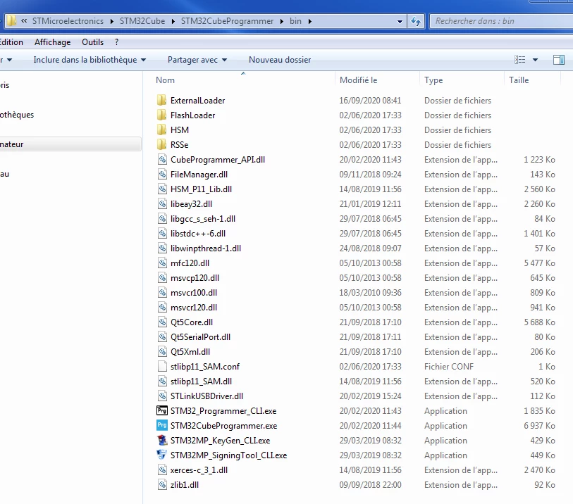

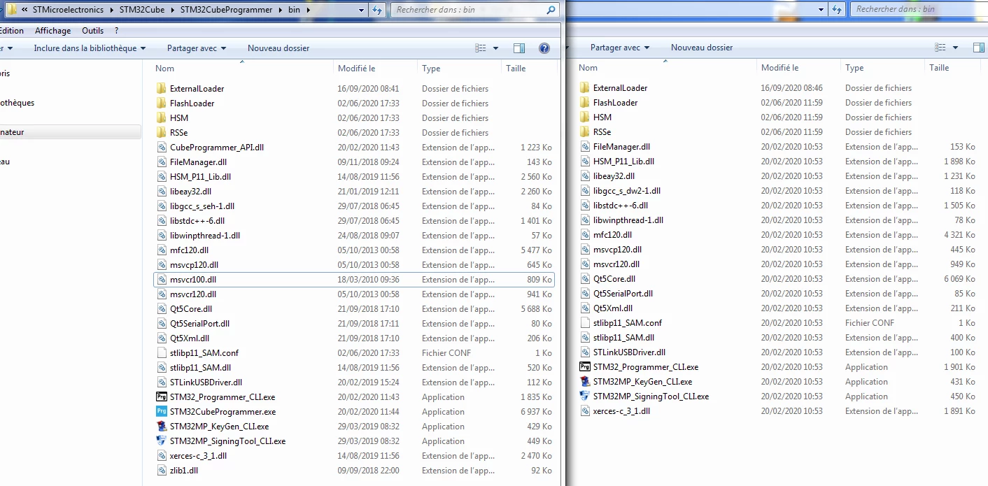

TGate.1
TGate.1Author
September 17, 2020
Hello Clive,
There is a subdirectory for external loader : C:\Program Files\STMicroelectronics\STM32Cube\STM32CubeProgrammer\bin\ExternalLoader
When I copy your .stldr file in the ExternalLoader, I can find it in STM32CubeProgrammer
I don't know if it's normal, but it's not the same path used for STM32CubeIDE :
C:\ST\STM32CubeIDE_1.1.0\STM32CubeIDE\plugins\com.st.stm32cube.ide.mcu.externaltools.cubeprogrammer.win32_1.3.0.202002181050\tools\bin\ExternalLoader
When I compare the two folders I don't have the same files in the \bin :
