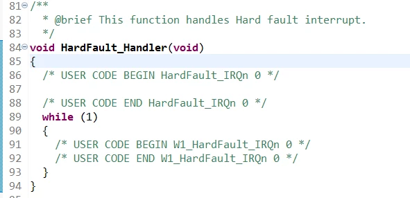

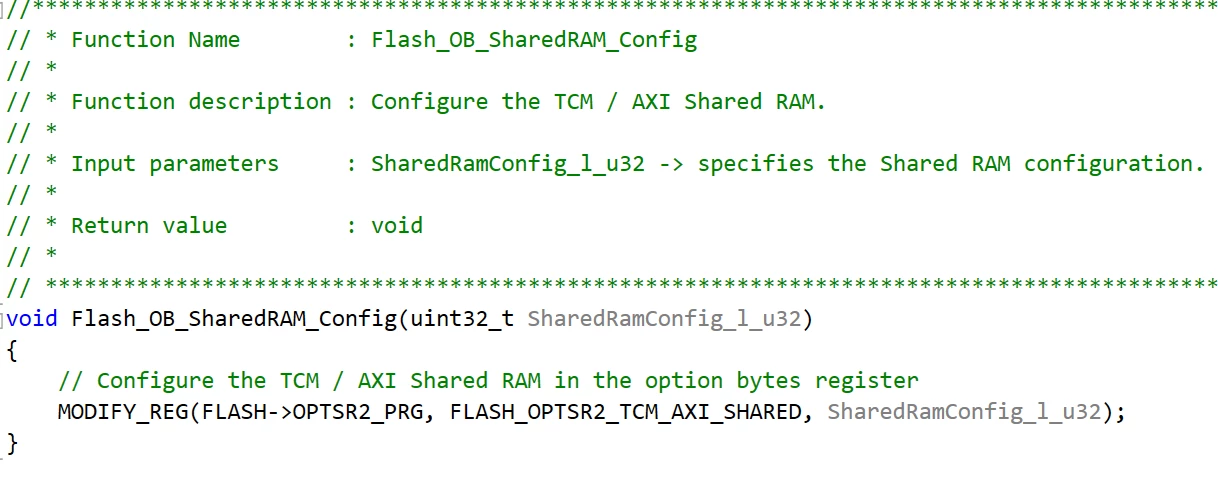

I got this issue when i am executing FLASH TEST, inside that i am calling OPTIONAL BYTE CONFIG
0693W00000QM3wzQAD.pngwhen i am calling it in main.c it is working fine but when i am trying to debug second time it is enter into HardFault_handler(void) function. when i am trying to reset or restarting it is not resolved it is throwing same fault
NOTE:- Now it is not working for all others modules. 0693W00000QM3yHQAT.pngplease help me with this issue,thank you in Advance

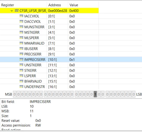

issue is when i am trying to debug different module in the same (stm32h723zg) nucleon board before hitting the break point it is Entering into Hardfault_ handler ()function.So, when i am trying to find solution. i got to know st community. Can you please help me how to find route cause and solution .
when i am observing SCB->CFSR register one flag(IMPRECISERR) is set with "1" ,AND one more register which is SCB->HFSR inside that FORCED set with "1".

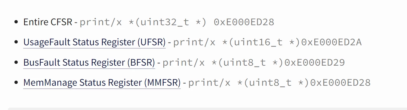

So your code is not reaching main function.
Use the below registers to know which error you are facing. And try to see from there.
Mostly UFSR or CFSR. But use a debugger and find the fault. 0693W00000QM4EyQAL.png
