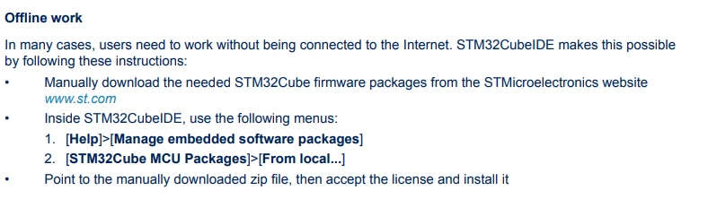

    I also have this problem.  In the context menu for the project, Generate Code is now grayed out after I logged in properly.
    Someone asked about working offline.  In the user guide UM2609 I found this mention about working offline in section 1.2.3:
    Visitor II
