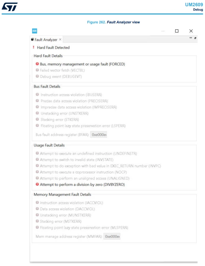

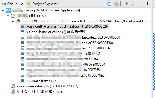

Hello @Andrew Neil ,
Fault analyzer toolbar is no more available but not the fault analyzer feature, which is still available but, in your case, you are working on a cortex M0 based microcontroller (STM32F0) so no fault related registers are available and no fault analyzer view subsequently for other cortex M4 -M33 -M7 you can still have the full view of the fault-analyzer.
There was a consensus to remove this feature Fault Analyzer toolbar from STM32CubeIDE and a change request has been raised to update the Release Note and the User Manual under this Ticket: 174829.
